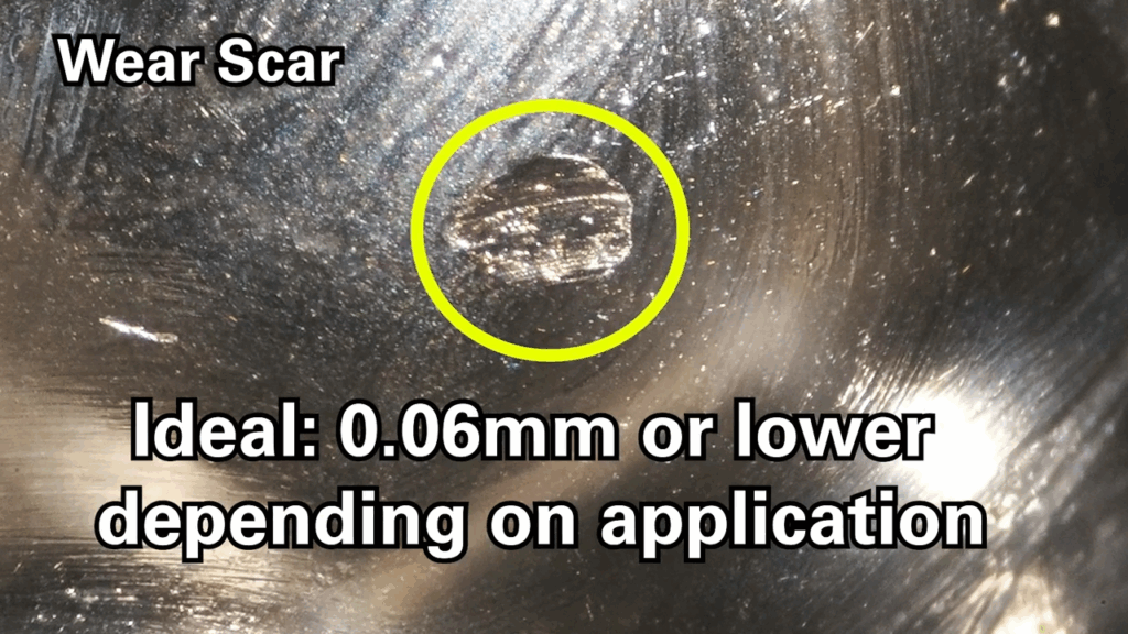

Figure 1: A ball wear test shows the wear scar measurement on a lubricated surface. A smaller wear scar indicates better protection against metal-to-metal contact. High-performance extreme pressure greases with molybdenum disulfide or other anti-wear additives help extend component life by reducing friction and wear. Courtesy: CITGO Petroleum

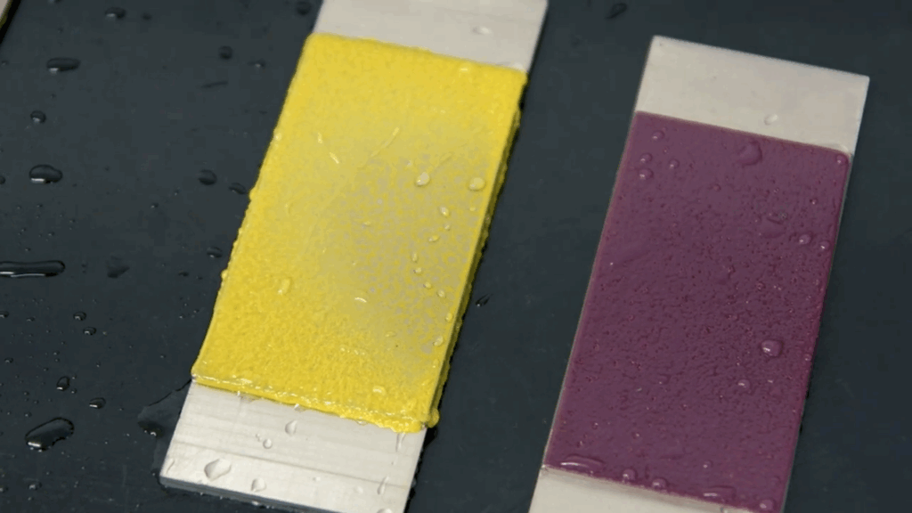

Figure 2: The grease on the right maintains its protective layer, resisting removal under high-pressure water exposure, while the grease on the left shows significant breakdown. Choosing grease with strong water spray-off resistance ensures continued protection in wet conditions and prevents premature lubrication loss. Courtesy: CITGO Petroleum

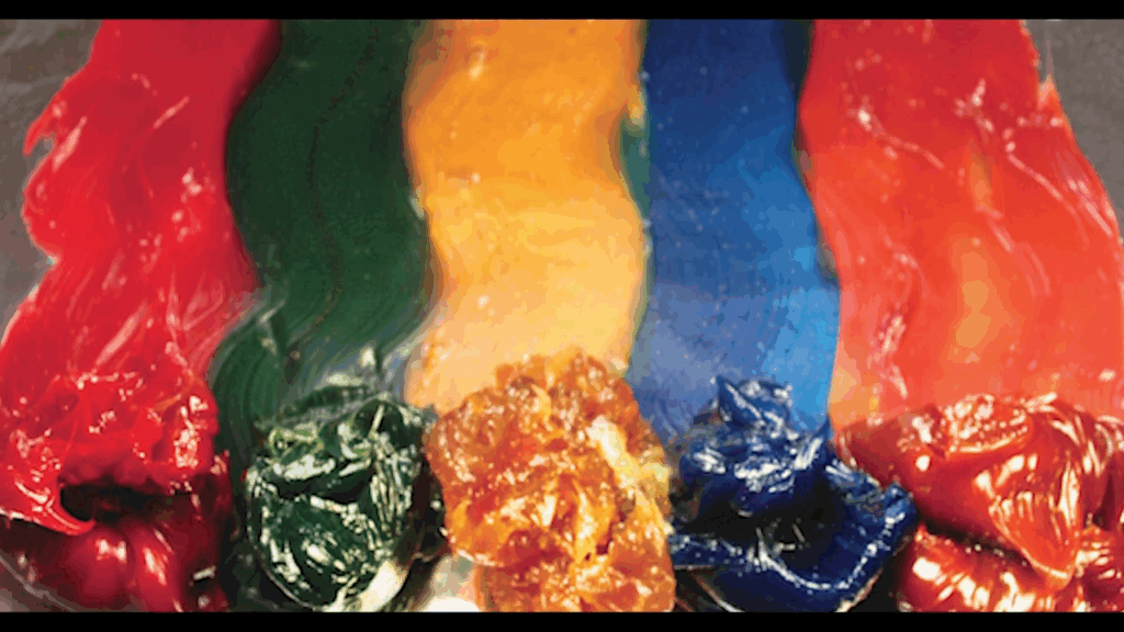

Figure 3: Grease color is often determined by dye additives and does not indicate performance characteristics. The choice of thickener, base oil and additives is what determines grease suitability for different applications. Courtesy: CITGO Petroleum

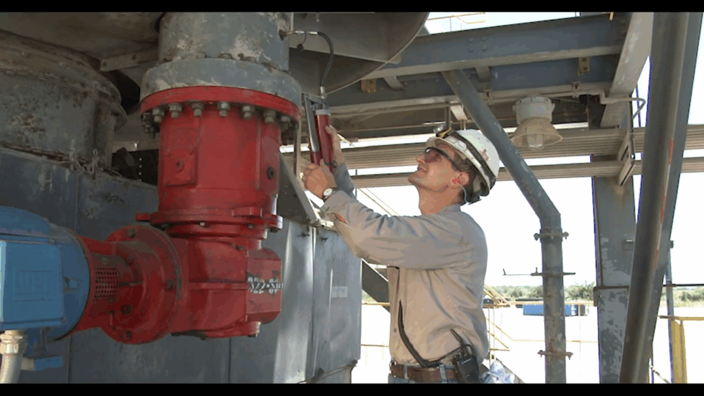

Figure 4: Routine maintenance and proper grease application techniques are essential for ensuring equipment longevity. Selecting the right grease and applying it at the correct intervals prevents premature wear and unplanned downtime. Courtesy: CITGO Petroleum
