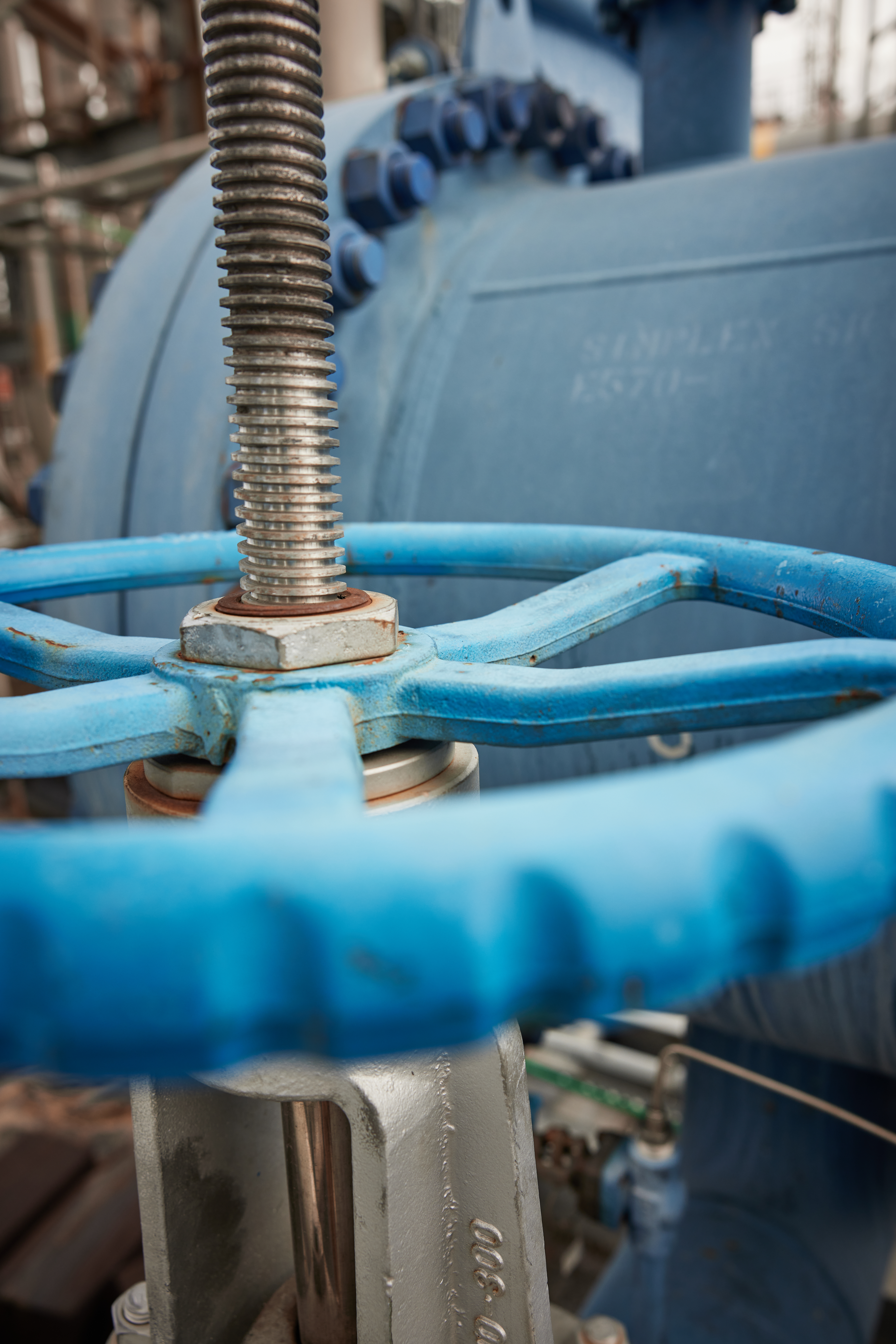

Gate valves
In OS&Y gate valves, the upper portion of the stem is threaded and moves through the handwheel, while the lower, non-threaded portion passes through lubricated packing and connects to the gate that controls flow. The actuating handle on standard gate valves is affixed to the top of the stem and away from the valve body with the stem.
Gate valves are typically serviced every 60 operating cycles or quarterly. In applications with highly caustic or acidic process fluids, valves should be inspected daily and serviced weekly. For most services, the packing is impregnated with a silicone-based lubricant to resist washout from process fluids or water. Valves with long stems may include a grease zerk at the top of the yoke to reduce operating torque.
When maintenance is required, lubricated packing should be replaced, often after back-seating the valve where applicable. Stem threads should be lubricated through the grease fitting at the actuator. If no grease fitting is provided, the valve should be cycled and the stem hand-lubricated until the threaded portion is fully coated.

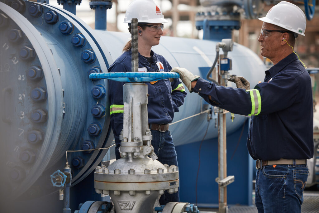

Special lubricants for valve actuators and gear boxes
An actuator is any device that opens or closes a valve by applying kinetic energy. Actuators can be manual, electric, pneumatic or hydraulic. Unlike solenoids, which send an electric signal to start an actuator, actuators perform the actual movement. Lubrication is typically applied to manual and hydraulic actuators.
Figure 3: Heat exchanger OS&Y isolation valve. Courtesy: CITGO Petroleum Corp.
Pneumatic actuators operate within an air-line system that includes a lubricator containing low-viscosity, arctic-stable fluids with good oxidation resistance. Hydraulic actuators are usually powered with International Organization for Standardization (ISO) 15–32 arctic-grade fluids or, in some systems, water-glycol emulsions, providing wear protection and oxidation stability.
Aside from maintaining fluid performance in extreme temperatures or sunlight, actuator lubrication is generally not severe duty. Systems should be inspected and serviced at least quarterly, with more frequent attention for valves in critical service. Hydraulic and air-line fluids should be replaced at least annually to prevent degradation from moisture or contamination.
