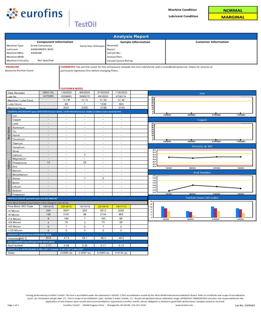

Worst practice #3. “We don’t have time to run an oil analysis.”
If there is one predictive maintenance practice that stands above all the others, it is routine oil analysis (see Figure 2). A standard oil sample gives visibility into contamination, viscosity changes, bearing wear, overheating, coolant intrusion and filtration health long before any of those issues show up on the shop floor.
Read the manufacturer’s fluid sample report. Not knowing the limits that flag an error, it will be nearly impossible to interpret correctly.
Think of it as a proactive checkup for the machine, so don’t wait for a compressor to fail.

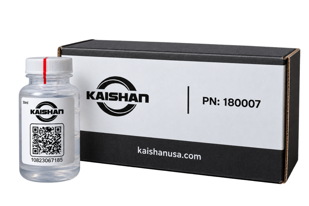

Figure 4: Drawing an oil sample and having it analyzed by an accredited, third-party laboratory is critical to the maintenance of any piece of rotating equipment. Courtesy: Eurofins TestOil
