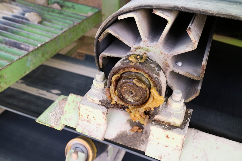

1.     Churning and energy loss
When too much grease is applied within a bearing cavity, the rotating bearing elements must work harder to move through the additional grease (see Figure 1). The excess grease being churned by the bearings is comparable to wading through water; the deeper you go, the harder it becomes to move forward and the more resistance. The added friction increases the energy consumption of machinery and drives operating costs higher. Moreover, the grease breaks down faster due to the excess grease generating additional heat, accelerating the oxidation process. The grease can no longer provide sufficient lubrication to the rotating element parts in a bearing to protect against wear; it loses lubricity and diminishes its overall efficiency. Bearings that need grease to remain cool suffer and will experience frequent maintenance and replacement due to over-greasing. The risks of over-greasing can be severe, including shortened bearing lifespan, increased downtime and costly production delays.
Figure 1: Grease flows out of a bearing, a sign of over-lubrication, which can lead to overheating and bearing failure. Courtesy: CITGO Petroleum

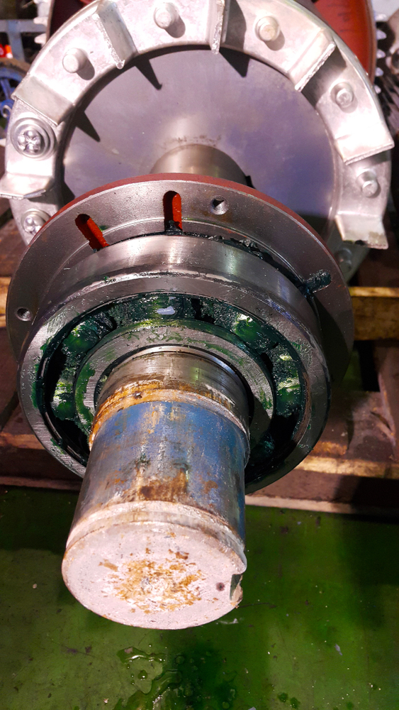

2.     Seal damage and contamination
Another critical risk of over-greasing is damage to bearing seals (see Figure 2). Grease guns can exert pressure up to 15,000 pounds per square inch (psi), while most bearing seals will not require that much pressure, no more than 500 psi. When using a grease gun, there is the risk of applying too much pressure. When the lever is pressed quickly, it sends a surge of grease and bearing seals may rupture or become dislodged. When this occurs, an entry point for contaminants like dust or moisture is created. In harsh environments, dust, dirt and other contaminants will be present; ruptured seals can allow these contaminants to enter, cause wear and lead to bearing failure. Maintaining the integrity of bearing seals is critical because it ensures the proper function of bearings over their operational lifespan.
Figure 2: Grease leakage due to over-pressurization, causing potential entry points for contaminants and leading to equipment failure. Courtesy: CITGO Petroleum

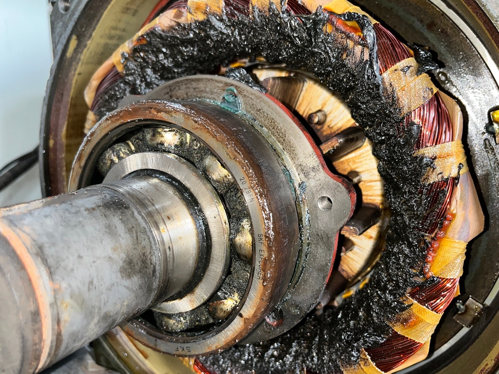

3.     Increased heat and oil bleed
As excess grease churns and generates additional heat, more friction is created within the bearing. The grease also tends to break down over time. Excessive heat can cause the oil to separate from its thickener, referred to as “oil bleed.” When oil bleeds excessively, the lubricating properties of the grease are compromised, reducing its ability to provide an adequate barrier between moving parts (see Figure 3). Equipment and applications such as electric motors or high-speed bearings require precise lubrication to combat friction and heat. This type of failure can impact them and cause slowed production times, increased maintenance costs and reduced overall efficiency of the machinery.
Figure 3: This bearing displays the results of high running temperatures commonly associated with over-greasing. When the dropping point is reached, the grease begins to bleed, the bearing runs dry and eventually fails. Courtesy: CITGO Petroleum

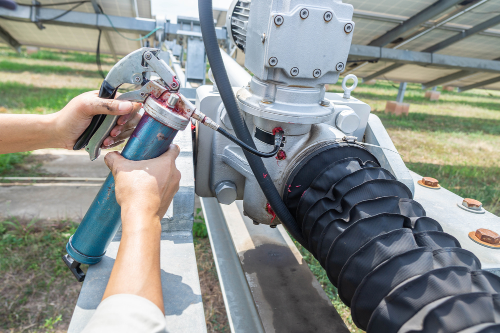

Nine steps to avoid over-greasing
Understanding the risks of over-greasing is the first step. The next is learning how to prevent it. Taking the time to assess current practices and identify areas for improvement will create the right strategies and tools maintenance teams can implement and strike a balance between too much and too little grease. Here’s how to keep things in check:
1.     Calculate the proper grease volume
Applying the proper grease is crucial for maintaining bearing efficiency and prolonging lifespan. Instead of relying on estimates or visual cues, maintenance teams can simply calculate the grease volume for specific bearing types using the industry standard SKF formula: G = 0.114 × D × B. In this formula, G represents the grease volume in ounces, D is the bearing outside diameter in inches and B is the bearing’s width in inches. This method helps avoid over-application and ensures bearings receive the optimal amount of lubrication for their intended use.
2.     Use feedback tools for precision
Maintenance teams can experience significant relief when they consistently apply just the right amount of grease. For example, ultrasonic sensors improve manual relubrication when connected to a grease gun, helping maintenance teams use the correct amount for the bearings. These sensors can monitor grease application in real-time for various bearing applications: electric motors, pumps and conveyors. The sensors will provide audio and visual display notifications during the relubrication process. With advanced maintenance technology like ultrasonic sensors, the benefits extend beyond applying the right amount of grease needed. Teams that invest in these tools will reduce equipment wear, increase overall productivity, reduce costly repairs and establish a reputation for reliability within their operations.

Figure 4: Effectively use calibrated grease guns can ensure the right amount of grease is applied to bearings, preventing over-lubrication. Courtesy: CITGO Petroleum
Regularly calibrating grease guns is also crucial to ensuring each application delivers the exact amount of grease needed, reducing the risk of over-pressurization and component damage. To calibrate the grease gun, follow these steps:
  • First, obtain a small scale and set it to ounces.
  • Second, with the grease gun, pump 10 slow, steady strokes of grease onto the scale.
  • Next, divide the number from the scale by 10, which will be the grease per stroke. Do this for each grease gun.
  • Finally, label the grease per stroke on the grease gun and recalibrate each year using the same grease.
