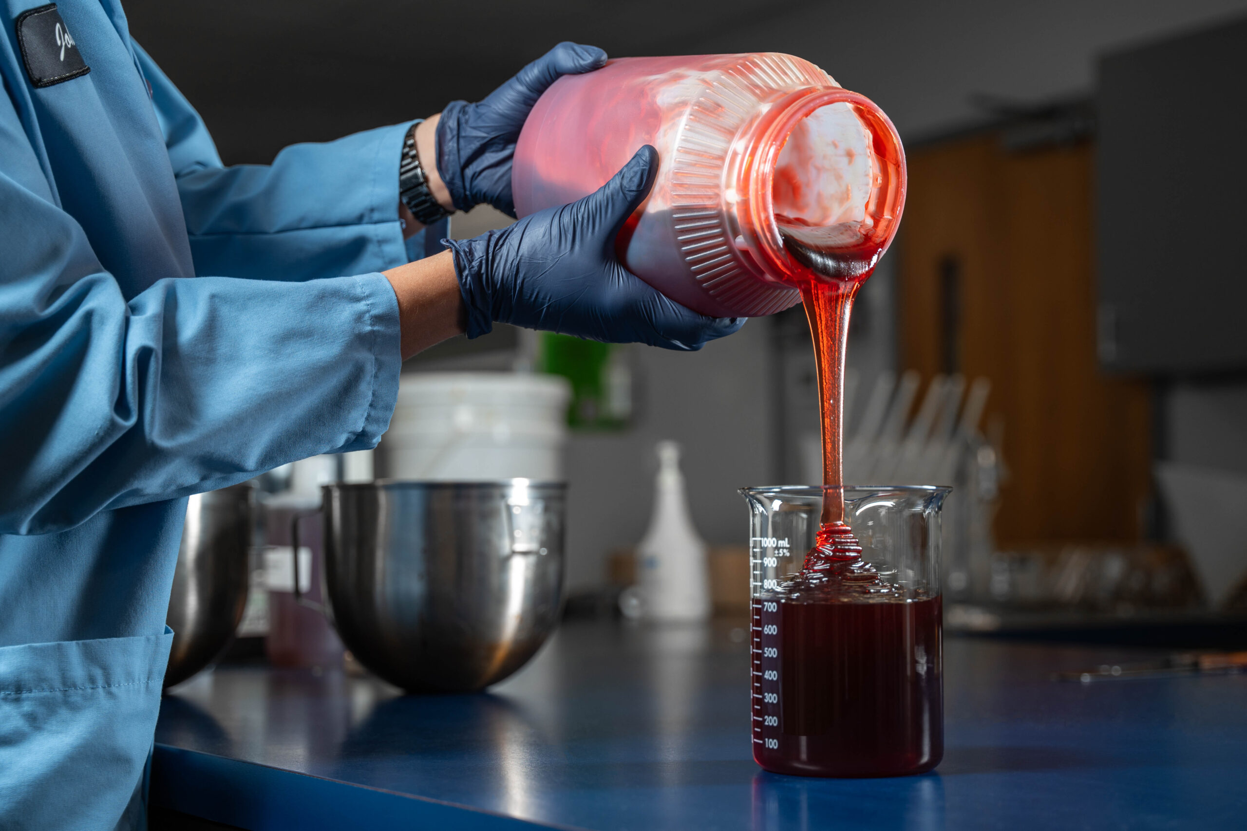

Lubricating grease is more than thick or viscous oil; it is thickened oil. The thickness of lubricating grease can vary greatly depending upon several factors. A thickener system turns lubricating oil into grease. Also, the fluid component could be watery like milk or viscous like honey. Likewise, base oil viscosities in greases vary. Further investigation shows the relationship between fluids and thickeners in lubricating grease formulations will influence field performance.
Proper grease lubrication involves careful selection of thickener chemistry, base oil type, base oil viscosity, National Lubricating Grease Institute’s (NLGI) penetration grade and additives to achieve the desired characteristics.

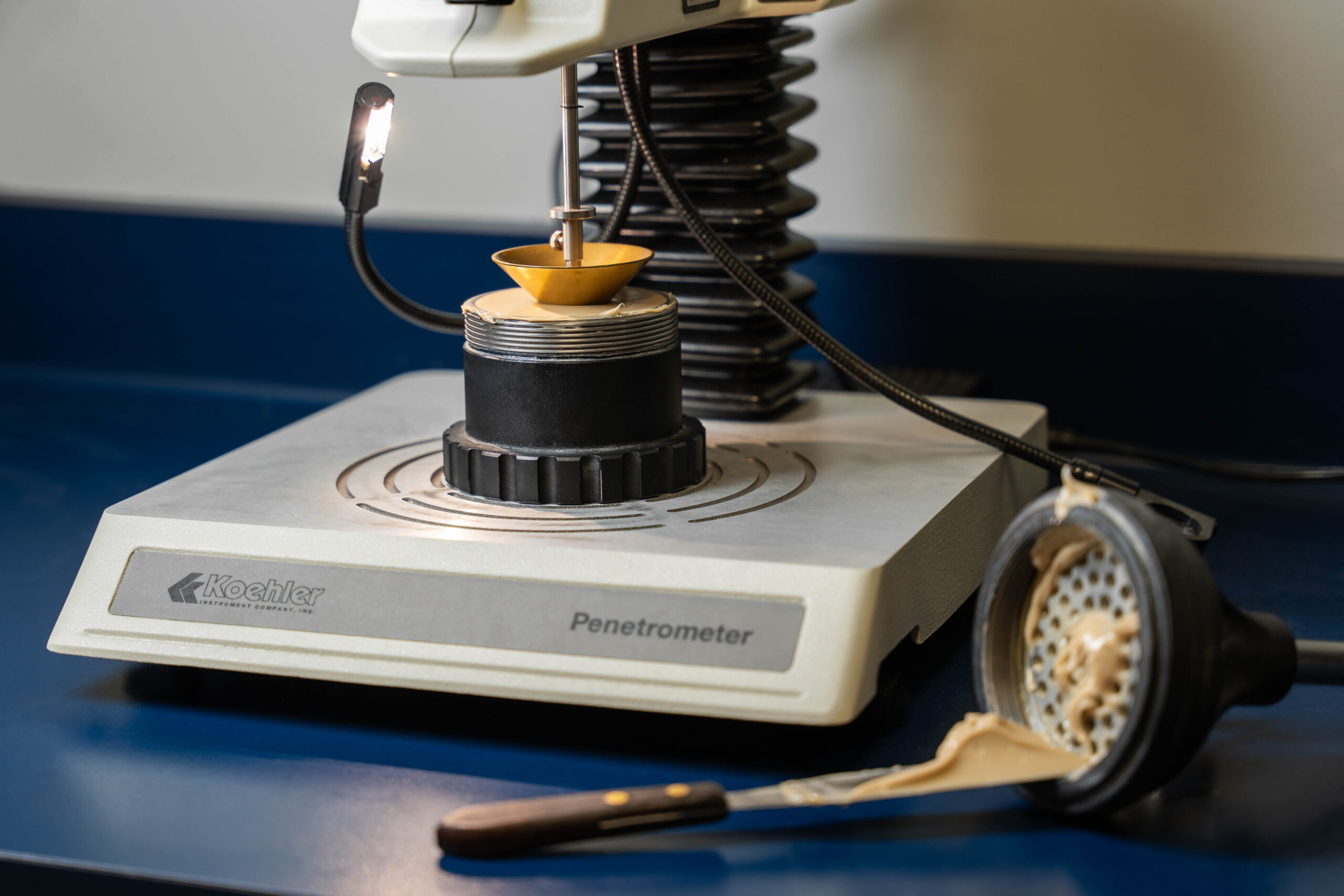

The NLGI grade of a grease is determined on a scale (see Figure 1) of the worked penetration (60 strokes) of a grease measured in cone displacement in 0.1mm increments taken at 25 ºC (77°F) in accordance with ASTM D217. The worked penetration value is then correlated to the NLGI grade.

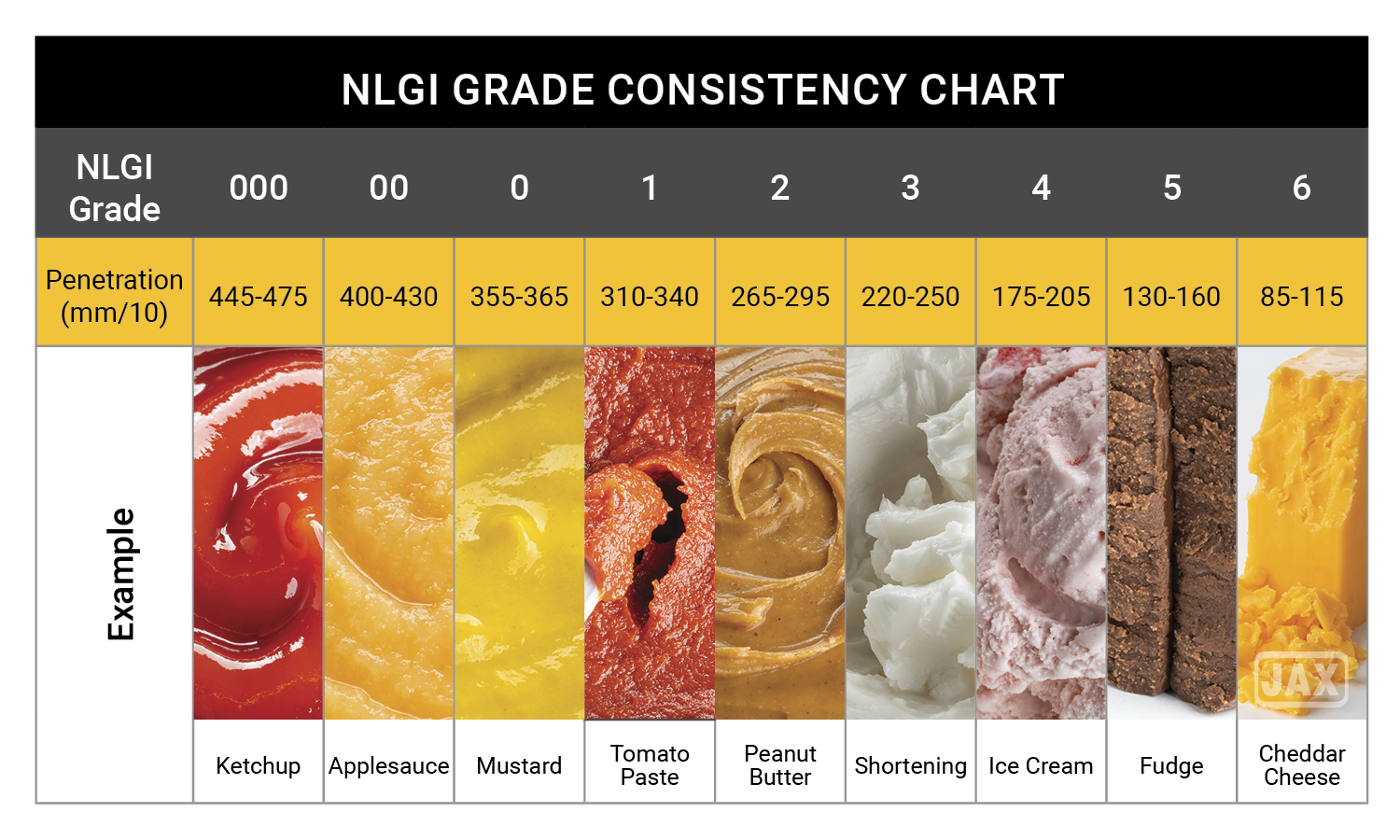

The NLGI grade defines the actual consistency or hardness of the grease. For illustration, the most prevalent NLGI grade, 2, has a worked penetration range of 265-295 mm/10, like the consistency of peanut butter. NLGI 1 grade greases have a worked penetration value of 310-340 mm/10, with a similar consistency to mustard. The more thickener content a grease has, the harder its consistency will be, resulting in less cone penetration and a numerically higher NLGI grade.

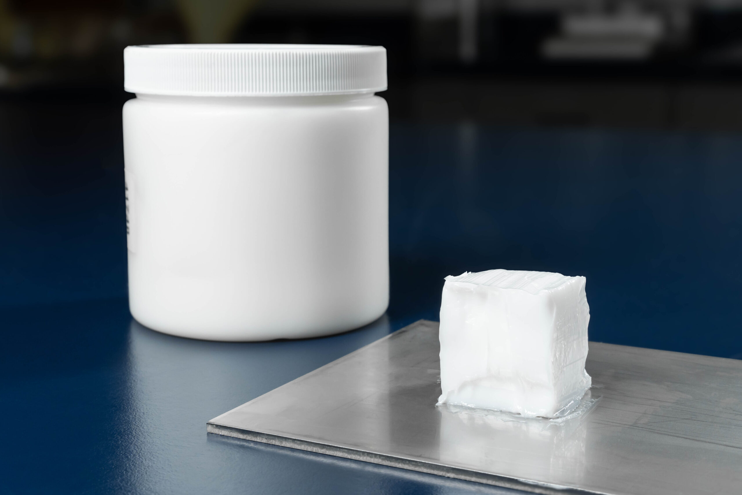

Applications without pumpability concerns that require long-term retention and stability such as valves or seals, will need a grease with a higher thickener content (see Figure 2). NLGI 3 grade grease, which has a consistency like shortening, possesses enough thickness to lubricate in addition to providing a stable barrier from contamination.

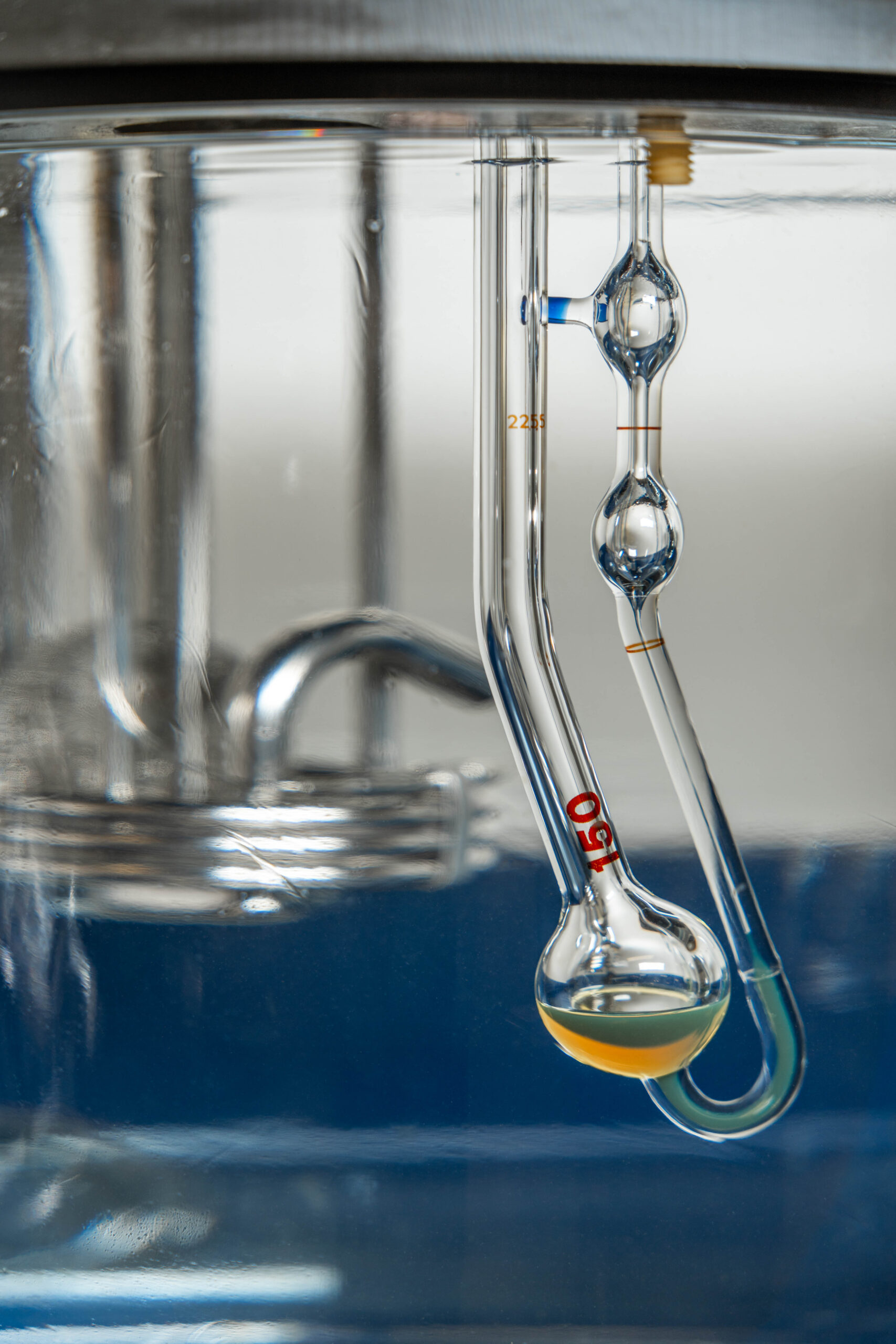

Base oil viscosity is determined utilizing ASTM D445 which measures the length of time for a liquid to flow through a capillary tube under gravity. Viscosity is measured centistokes (cSt) and recorded at 40ºC to 100ºC (104°F to 212°F), with the viscosity in cSt at 40°C used to determine the ISO grade.

Just remember, increasing the base oil viscosity in a grease formulation from an ISO VG 68 to an ISO VG 460 will not affect the hardness or the consistency of the NLGI grade. An NLGI 2 grade grease can be manufactured with a thin ISO VG 22 base oil or a viscous ISO VG 1500 base oil (see Chart 1).
Chart 1: NLGI grade and worked penetration value ranges as compared to food items of similar consistency. Courtesy: JAX Inc.
