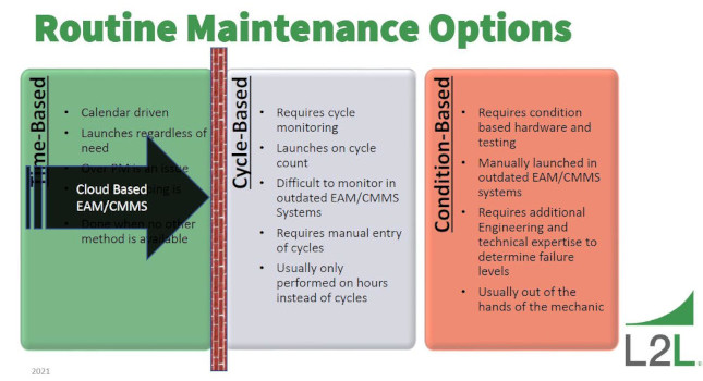

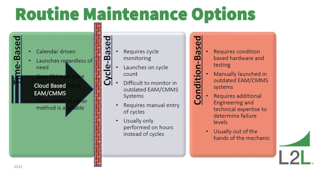

Eric Whitley: It’s an evolution. What going from cycle-based to condition-based monitoring allows us to do is that we can then begin to see and correlate that data that, “Hey, I know that I have a meantime between failure, that I’ve done the calculation, that it has cycles. I know that I should be coming up on a failure. So now I’m going to begin to watch for a change in that condition. If I don’t see a change in the condition that correlates with my cycle count, then I know I can either make some adjustments to my cycles as far as failure goes or make some adjustments to my condition monitoring process, because I saw a failure and my condition monitoring didn’t tell me that that was coming. Having the cycle count allows us to see when those failures should be happening and correlate those two things together.
Routine maintenance options. Courtesy: Leading2Lean
Routine maintenance options from time-based to cycle-based to condition-based. Courtesy: Leading2Lean
