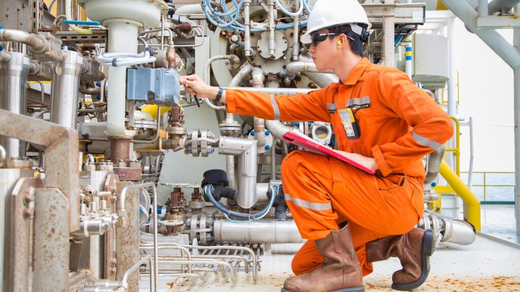

Figure 1: Regular inspection and servicing of industrial valves are key to ensuring efficiency, safety and longevity. Preventive care prevents costly failures. Courtesy: Emerson
