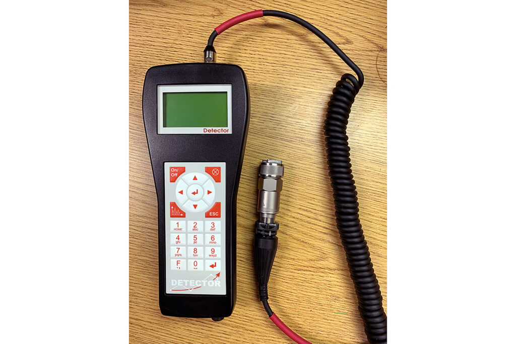

Analyzing compressor vibrations
One of the easiest and most cost-effective steps in predictive maintenance is vibration analysis. When done regularly, vibration analysis monitors the health of a compressed air system from installation and provides an in-depth view of what is ailing the system — and more importantly, what could ail any system in the (near) future.
Vibration analysis can be done through service providers at regular intervals or can be done on a continuous basis with sensors. Vibration sensors measure the level of vibration frequency to help determine imminent failure points within the compressor. With the right equipment and training, professionals can determine exactly what component is failing.
Several problems may be identified using vibration analysis including a developing issue with a thrust or radial bearing and if the problem lies in the internal race, outer race, ball spin or cage. Also, early-stage lubrication bearing issues like spalling, pitting and cracking can also be identified. Other detectable issues include bearing wear, misalignment, rotor imbalance or something as simple as general looseness.
Vibration analysis is an important tool to use regularly to keep your air compressor properly maintained and running as efficiently as possible (see Figure 5).
Figure 5: Every compressor has its own vibration signature and documenting and tracking that unique vibration allows the owner to “see” several performance issues. Courtesy: Hitachi Global Air Power
