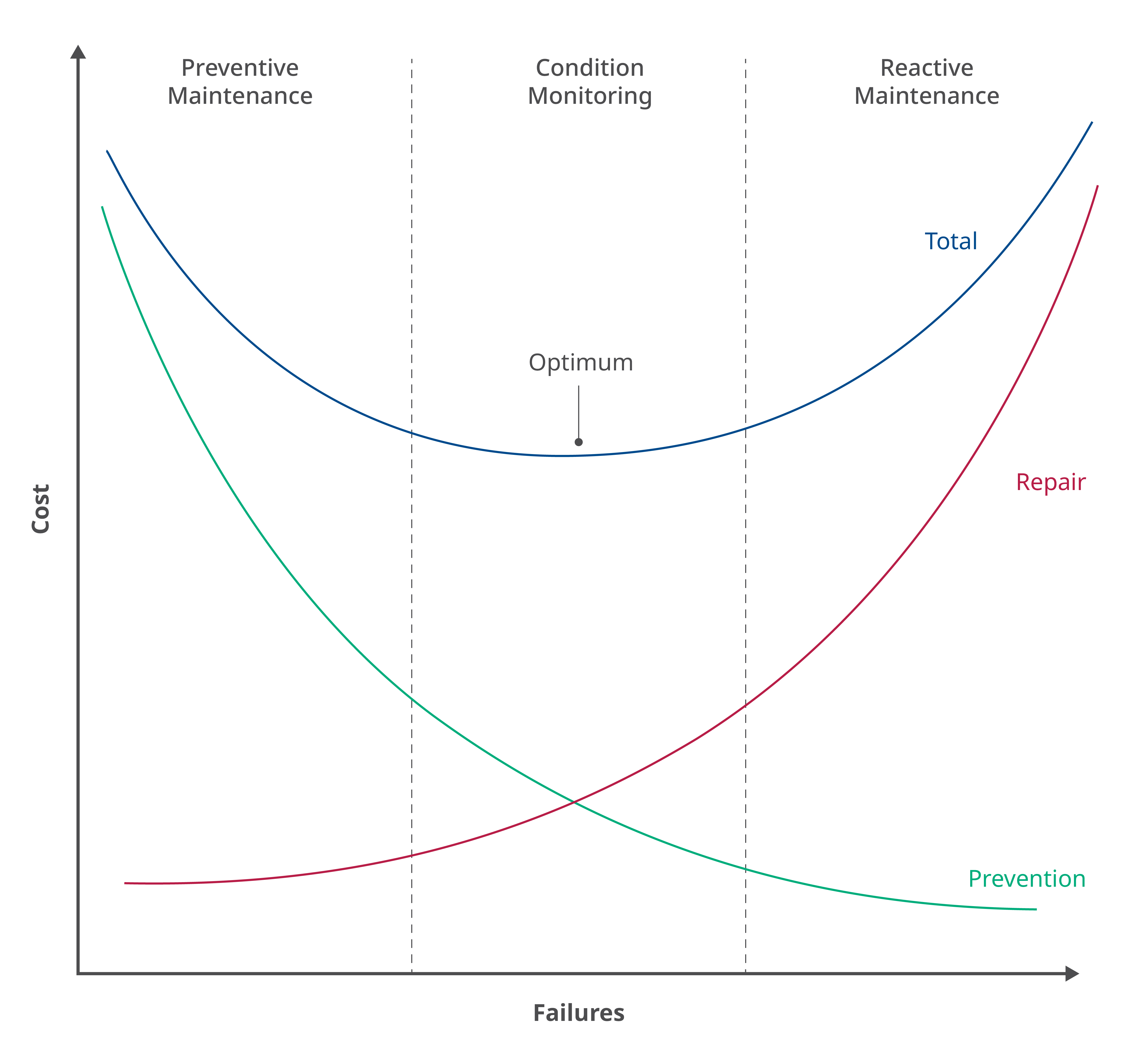

CM systems bring a wide range of benefits. First and foremost, CM tools help teams deliver operational benefits. Remote access to the system allows centralization where a team of experts can perform consistent diagnostics across the entire enterprise (local or multinational locations), avoiding expensive traveling to sites. This is an important element for offshore applications — such as floating production storage and offloading units — and for liquefied natural gas carriers, remote mine sites and others.
Figure 1: Condition monitoring strikes a balance between the cost of performing preventive maintenance and the cost to repair or replace failed equipment under a reactive maintenance program. Courtesy: Emerson

In addition, CM solutions also unlock maintenance benefits. A CM system directly reduces maintenance costs, with fewer work orders and more targeted activities. It can replace preventive, off-line measurements, possibly executed by costly external service companies and reduce labor time and associated costs due to shorter mean time to repair. Moreover, knowledge regarding the failed component allows targeted repairs instead of trial-and-error campaigns, with less capital commitment for spare parts inventory.
All these benefits can bring significant gains in risk avoidance. Risk is the product of two factors: consequence and probability or frequency. Consider a catastrophic compressor failure with a potential consequence of $500,000 in production loss, labor costs and spare parts. If this event occurs at a frequency of once every 10 years, this represents an annual risk of $50,000 per year. If it occurs every two years, the annual risk is $250,000. At such levels, it does not take many saves before a CM system pays for itself.

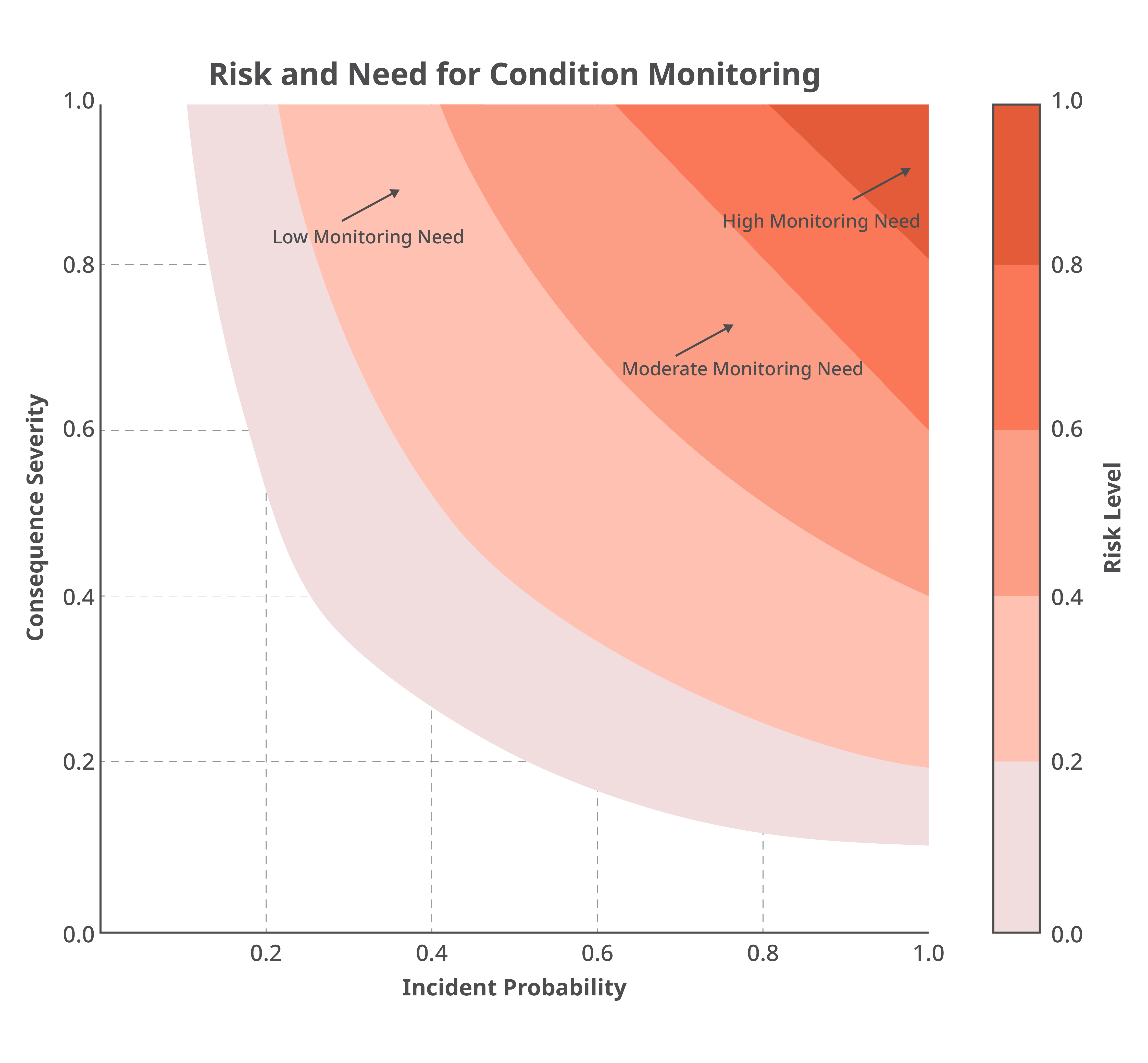

Machine criticality is another essential factor to consider when identifying the proper monitoring technology and scope as part of a ROI roadmap. One factor of the criticality definition is the well-known risk matrix. It relies on previously mentioned factors: consequences and probability.
Risk assessment is a challenging and complex task and in terms of criticality, CM project teams must consider many factors including process layout (e.g., single line or multiline), profits per hour (in case of production loss), ability to keep the process running downstream of the failed machine, time and cost for shutdown and startup, equipment redundancy (i.e., availability of backup machinery), average mean time to repair of the evaluated assets, failure history of the machinery and availability of maintenance experts and tools.
Figure 2: Dependency between asset criticality and condition monitoring system. Sources: Corporate finance Institute, Harvard Business School, Deloitte Consulting, AIChE (The Global Home of Chemical Engineers), National Academy Press, Reliabilityweb, National institutes of Health (NIH), Emerson internal references. Courtesy: Emerson
One way to show dependency between criticality and the CM system’s scope is shown in Figure 2. The more critical the asset, the more advanced the CM technology should be to detect all impending failures and avoid costly consequential failures.
