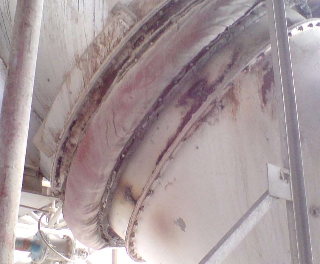

For nonmetallic expansion joints, the best maintenance practice involves replacing the bellows (fabric belt) and thermal insulation pillow in case of a rupture. Regular visual inspections of the bellows are crucial and, in some cases, a thermal camera inspection can be beneficial to detect issues early.
If the bellows of metallic expansion joints rupture or leak, the entire expansion joint must usually be replaced. Regular maintenance and inspection can help prevent such occurrences and extend the joints’ lifespan.
Preventive maintenance for installed expansion joints
Once the expansion joint is installed, operators should perform regular preventive maintenance checks. For nonmetallic expansion joints, frequent visual inspections should include:
  • Ensuring the outside bellows are free of material deposits that could obstruct air circulation.
  • Checking for any missing bolts in the clamping bars.
  • Looking for signs of rupture or leakage in the bellows.
  • Observing any localized changes in the color of the outside bellows, which could indicate overheating or other issues.

Figure 3: Examples of expansion joints monitored under preventive maintenance programs. Courtesy: Teadit Group
