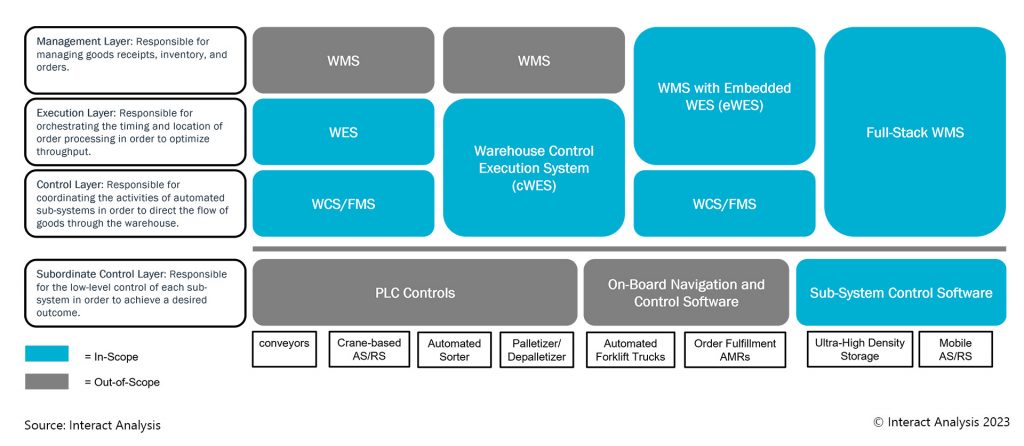

Visual depiction of what's included in a warehouse execution system (WES). Courtesy: Interact Analysis
Visual depiction of what’s included in a warehouse execution system (WES). Courtesy: Interact Analysis
For example, by slowing down order release if the put-wall is flooded. Furthermore, the execution layer is used to avoid congested areas of the warehouse. For example, if the shuttle-system is operating at full capacity, the execution layer can direct pickers to the forward-pick area for manual picking.

The WES orchestrates the timing and location of warehouse workflows in order to optimize throughput. We have three criteria for a system to be described as a WES: 1) it must be able to dynamically release orders to the warehouse based on the utilization status of the automation equipment, 2) it must be able to orchestrate multiple sub-systems, and 3) it must be able to orchestrate both man and machine (e.g. if the automated shuttle-system is at capacity, the system directs a manual picker to the forward pick area instead of using the shuttle system).

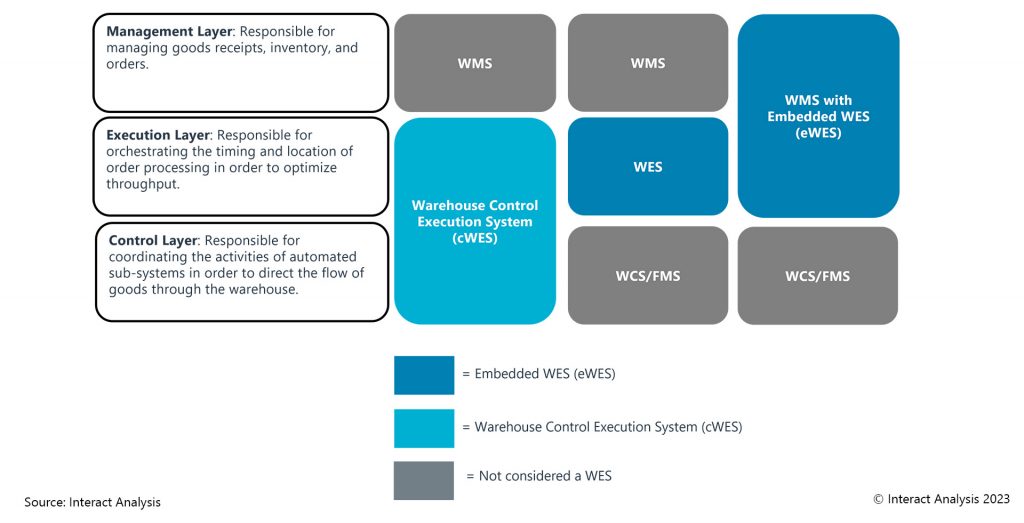

The various types of warehouse execution systems (WES). Courtesy: Interact Analysis
Two types of warehouse execution systems
As we mentioned before, the first warehouse execution systems were developed out of existing WCS solutions because they had real-time visibility of the utilization of the equipment and could therefore control the order release timing based on system availability. In effect, execution capabilities were bolted on to existing WCS solutions. We define warehouse execution systems that grew out of WCS solutions as warehouse control execution systems (cWES) solutions.
However, a warehouse execution system doesn’t need to control the automation in order to gain real-time visibility into the system availability. In many cases, the execution layer doesn’t actually control the automation at all. For example, Manhattan Associates’ Active WM solution receives real-time information from the WCS and uses this data to provide execution capabilities. In the case of Manhattan Associates’ solution, the WES is embedded into its WMS. We therefore define WES solutions that sit above the WCS as embedded WES (eWES) solutions.
Whilst most eWES solutions are truly embedded into the WMS, some can be sold as stand-alone solutions, such as Softeon’s WES which can either be embedded into its WMS or sold independently. If an eWES is sold as a stand-alone solution, it would therefore sit between the WCS and the WMS as an additional layer.
