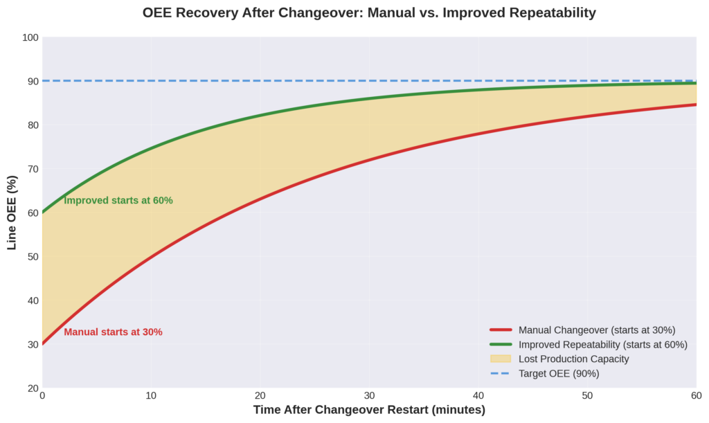

Figure 1: Automated changeovers with improved repeatability double starting overall equipment effectiveness from 30% to 60%, significantly reducing lost production capacity (shaded area) during ramp-up. Courtesy: Salas O’Brien.

The less obvious cost occurs during the restart. After a manual changeover, lines rarely reach full target efficiency right away. Instead, there’s a ramp-up period where operators and maintenance staff find a missed adjustment, a guide rail that’s slightly misaligned or an inspection system or coder not configured for the new product. Overall line efficiency might start at a low level and take significant time to climb back to the targeted line efficiency. Every minute spent in that ramp-up phase is production capacity lost and it pushes scheduled runs later into shifts that are already short-staffed.

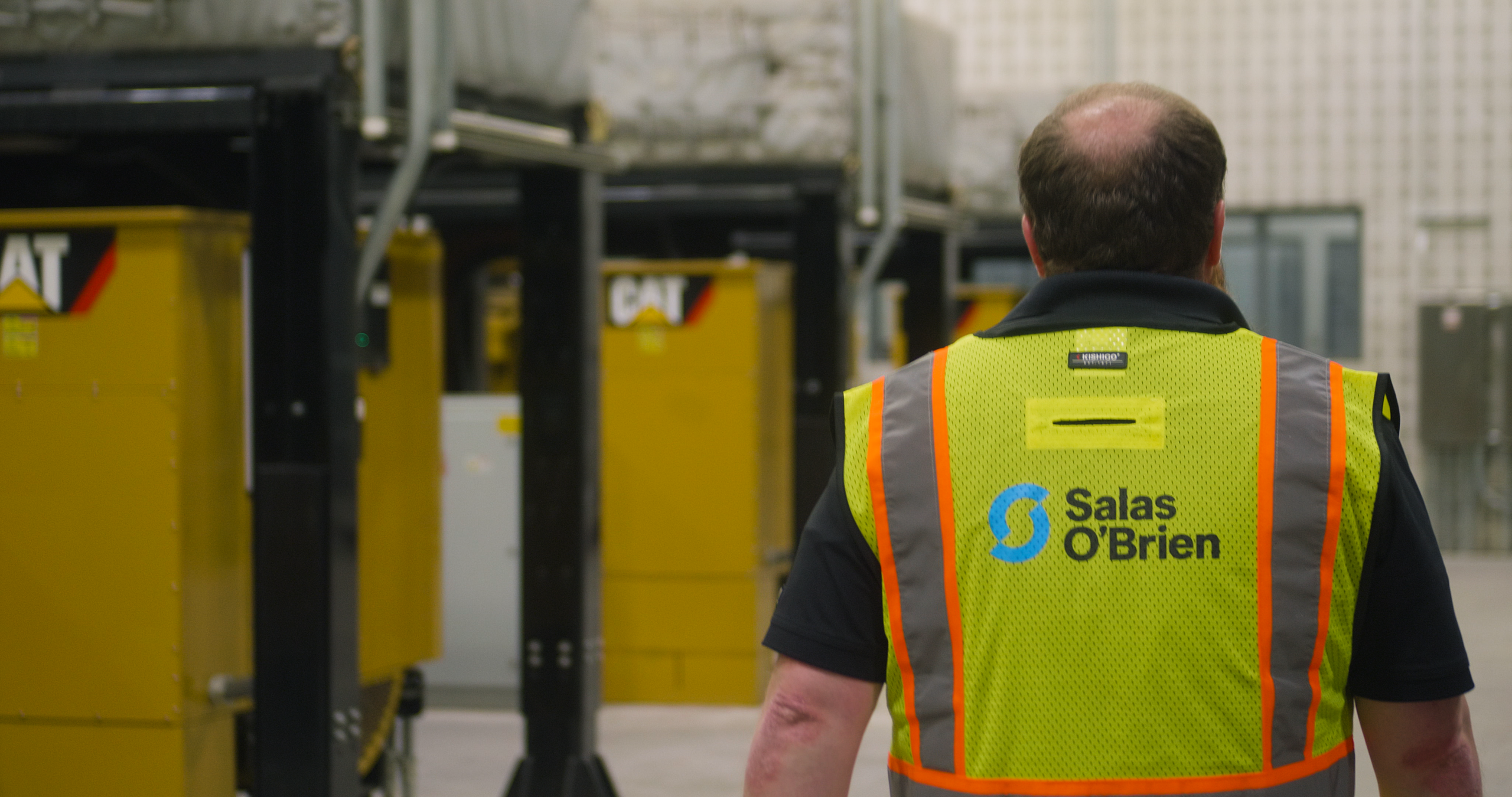

Figure 2: Salas O’Brien reviews backup generation infrastructure, an area where automation is playing a growing role in improving monitoring, reliability and system readiness during changing operating conditions. Courtesy: Salas O’Brien
