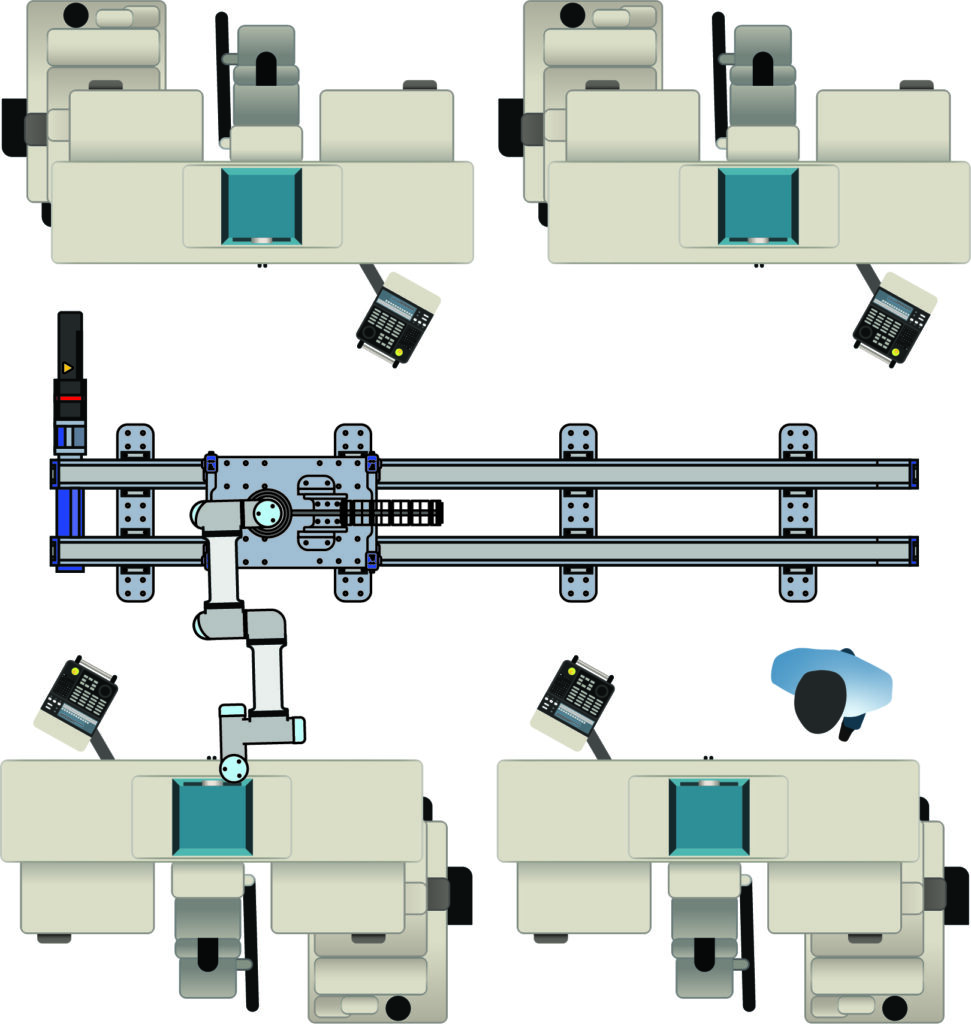

CTUs are becoming increasingly popular for operations requiring multiple tasks, such as milling, lathes, testing, inspection and welding. Adding a seventh axis of motion enables one robot to perform various operations across multiple pieces of equipment or workstations (see Figure 1).
Figure 1: The flexibility of a cobot transfer unit, which can expand horizontal operating range up to 32.8 feet, significantly boosts productivity and output. Courtesy: Thomson Industries Inc.
A robot equipped with a seventh axis, for example, could load one machine and then, while that machining cycle runs, move on to load another machine. This capability reduces the need to deploy multiple robots to accomplish different tasks.

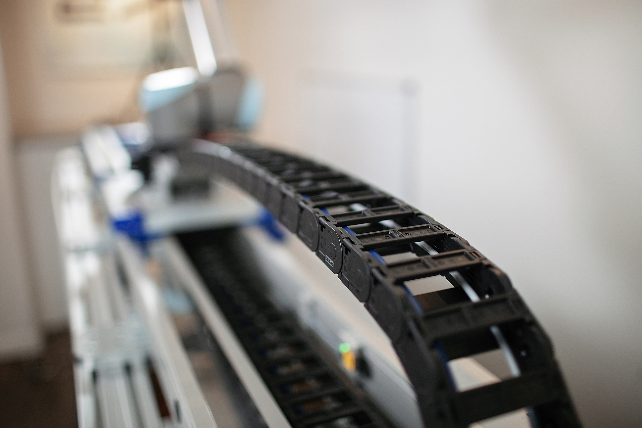

Mounting the CTU from the ceiling can provide operators with even greater access to the task area if steel stanchions, rigging or other structural supports are installed. You do, however, still must figure out what to do with the cables, which could otherwise hang into the task area. Some manufacturers use cable management trays, which keep the cabling out of the way (see Figure 3).
Figure 3: Many seventh axis manufacturers often offer tray solutions to simplify cable management. Courtesy: Thomson Industries Inc.
