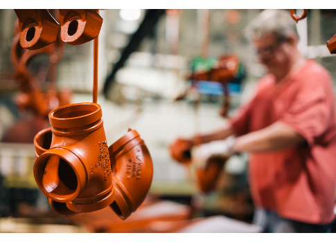

Making ductile iron products
Manufacturing processes at Victaulic’s Forks facility are straightforward. First, induction furnaces melt scrap iron and the necessary additives at 2,800 F according to recipes determined by the company’s metallurgists. Next, the molten metal is poured into sand molds, which form parts that are machined and then assembled into Victaulic’s products.
"Other than the alloys we use, such as carbon, magnesium, and silicon we use recycled metal we purchase from scrap recovery services for each furnace charge," said plant manager Tim Martin. "We also re-melt 100% of the sprue from our castings and ductile iron turnings from our machine shop."
