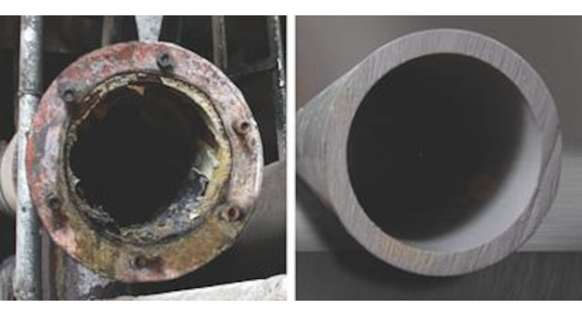

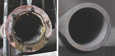

As the table above shows, the texture of a metal pipe’s inner surface is naturally rougher than that of CPVC and other plastic piping, even when CPVC is decades old. This rough texture allows fluid to build up in these niches and degrade material quickly, especially at welds and joints. Furthermore, metals “pit,” where tiny divots form along the length of the pipe. This diminishes the pipe’s wall thickness, which reduces its pressure-bearing capability and can introduce corrosion chips into the fluid traveling through the pipes. Corrosion can also cause pipes to fail. By contrast, the naturally smooth, innately corrosion-resistant interior surface of CPVC is resistant to scaling, pitting and fouling, keeping its C Factor high over the service life. (Figure 3)
A metallic pipe (left) and a CPVC pipe (right) after the same length of service. The metallic pipe has significant fouling inside, while the CPVC pipe remains in like-new condition.
Figure 3: A metallic pipe (left) and a CPVC pipe (right) after the same length of service. The metallic pipe has significant fouling inside, while the CPVC pipe remains in like-new condition. Courtesy: Corzan Material and Piping Solutions.
