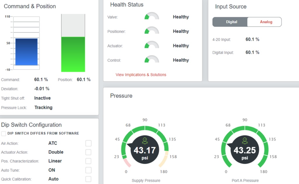

Control valves positioners have evolved exponentially in recent years. Positioners now can provide a full stack of valve, actuator, control and positioner diagnostics, but these diagnostics are different for each OEM vendor and hard to understand the severity of each alarm and of each device to know when it is a nuisance alarm or when to act.

Question: Although not an issue, can the system determine slipstick on a valve?
Answer: By monitoring the valve friction, we can identify “high friction,” which can cause loop oscillations, poor position control, jerky motion, or valve slipstick. All those symptoms can be caused by build-up from the process on the stem, trim or seat, by a failing bearing or guides in the valve or actuator, galling of the trim or stem, excessively tightened packing, linkages, or other valve or actuator mechanical issues. Indirectly, the system can determine slipstick by monitoring the valve friction.
