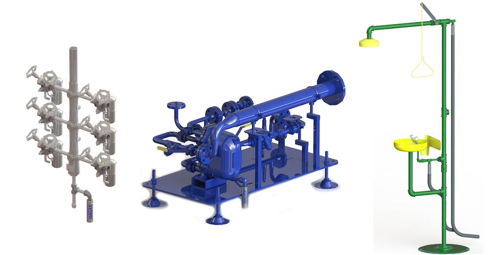

Maintaining water-bearing equipment in a facility can be tricky, especially in wintertime. Ensuring piping, safety showers, condensate systems and pumps are kept from freezing conditions comes with several challenges. When these systems are exposed to freezing temperatures, they become vulnerable to damage and water supply disruptions, which cause hazardous working conditions.
Freeze protection is critical in applications such as:
Piping, valves and fittings
Pumps
Filtration systems
Holding tanks
Condensate systems
Fire lines
Freeze-sensitive equipment
Backup protection on traced systems/equipment.

Freeze protection solutions for piping
Water line thermostatic freeze protection valves often use a specifically designed thermostatic wax actuator technology with an “install it and forget it” approach, simplifying the management of freeze protection.
A HAT/FP valve allows flow when the thermostatic actuator senses 35 °F and will remain open as long as the discharge water temperature is below 40 °F. Installed in the standard flow direction, the actuator will sense the ambient temperature and open to initiate flow, then respond to water temperature.
Installed in the reverse flow direction, the wax actuator will always sense and respond to the water temperature to control the flow. Once the water temperature is above the freeze danger zone, the valve will modulate closed to conserve water.
