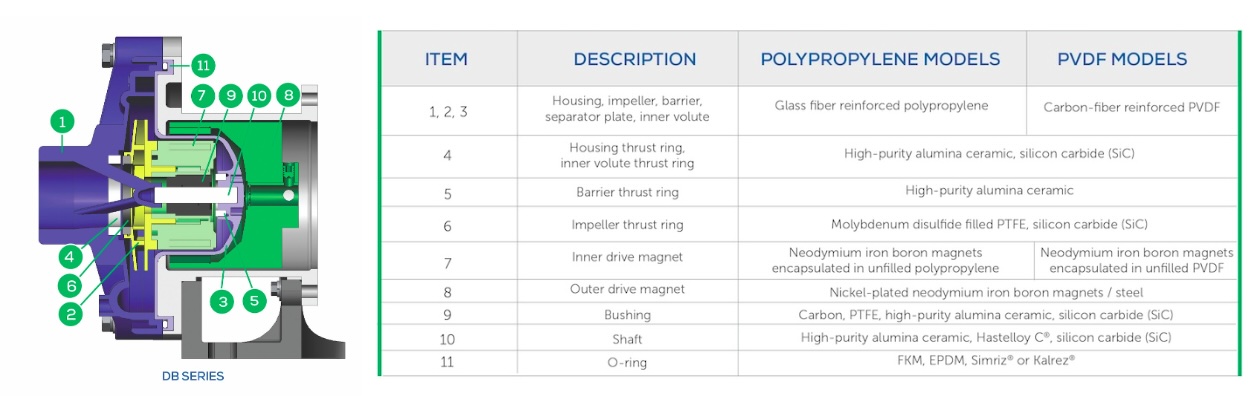

Figure 1: Magnetic drive pumps feature leak-free technology that replaces mechanical seals. Courtesy: Finish Thompson
The mag-drive design includes 10 main components:
  1. Housing: Also known as the casing, this component is located at the front of the pump. It contains the suction and discharge connections as well as a thrust ring.
  2. Impeller: This component contains a thrust ring that partners with the thrust ring inside the housing. Together, the rings guide liquid into the eye of the impeller and absorb any forward thrust in the pump.
  3. Impeller drive: Connected to the impeller, the impeller drive contains the magnets that drive the pump.
  4. Bushing: This component is located inside the impeller drive. In conjunction with the shaft, the bushing keeps the impeller drive centered inside the pump.
  5. Shaft: This part supports the rotating impeller/impeller drive assembly. The shaft prevents the impeller from being magnetically attracted to the drive magnet assembly that is located on the outside of the pump.
  6. Barrier: Located at the rear of the pump near the motor, the barrier on a magnetic sealless pump is solid. This differs from a mechanically sealed pump, which would feature an opening in the barrier.
  7. Housing O-ring: This component seals the pump to prevent leaks. It is situated between the impeller housing and the barrier.
  8. Drive magnet assembly: Also known as the outer drive magnet, this assembly is connected to the motor shaft and contains the magnets that rotate the impeller drive inside the pump when the motor shaft rotates.
  9. Magnets: The magnets that drive the pump can be constructed of a variety of materials, including samarium cobalt, neodymium or a mixture of ceramic and neodymium.
  10. Motor: There is a wide range of motor types that can potentially drive a magnetic sealless pump. The specific motor selected must be based on pump compatibility.
