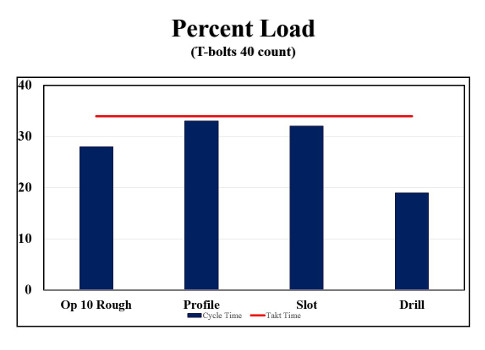

One client’s operation employs both processes. One product line is high-volume hardware parts milled in increments of 40. The parts are milled for a series of characteristics, then re-loaded on a different fixture in a different orientation to the cutting tool, which completes the part. So far, so good.
At the other end of the spectrum, the company also produces a high volume, complex part that’s milled gang style. Four parts are milled in the first operation. Then the second operation mills two parts at a time. The work flow would be okay if the second operation was half the time of the first. Unfortunately, the times were equal, causing a backup of work in process at the second operation.
It got worse. Following those two CNC operations, a series of six manual operations followed, compounding the backup. The six manual operations were fairly equal in machining time, but the operators ran the process in batch mode, further contributing to piles of work in process between operations.
How to Lean out this process? Use the takt time and the percent load chart to balance the operations. To increase capacity during peak demand periods, we added a parallel manual machining process. Research opportunities to transfer the work to CNC equipment, so that material flows through the downstream could process smoothly.
