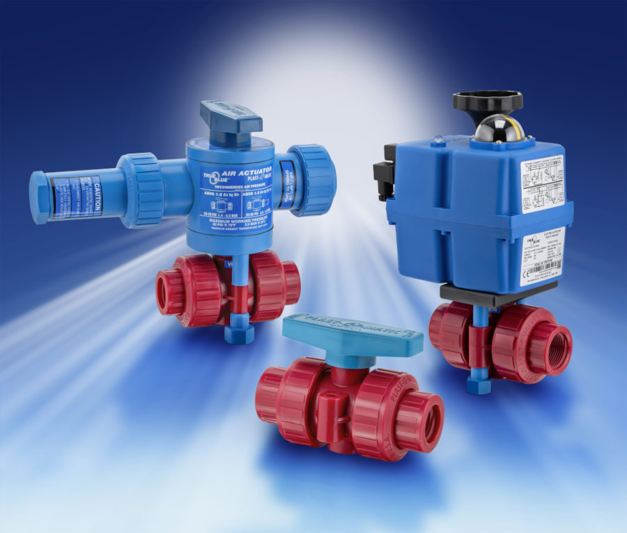

An effective treatment to reduce microbiological activity would be the use of sodium hypochlorite. However, sodium hypochlorite feed systems present their own challenges due to the chlorine component, which is corrosive to many common fluid handling systems. The Peters Table references the chemical resistance of plastic and metal piping under pressure with water treatment chemicals that are used to treat microbiological activity (1). Red Kynar PVDF can be found as a material of construction for these sodium hypochlorite feed systems for that reason, with a wide array of fluid handling components available. Figure 1 shows an example of different types of Red Kynar PVDF ball valves.
Figure 1: Red Kynar PVDF ball valves are available in various types and sizes. (From right to left, air actuated, manual and electrically actuated).
Figure 1: Red Kynar PVDF ball valves are available in various types and sizes. (From right to left, air actuated, manual and electrically actuated) Courtesy: Plast-O-Matic Valves, Inc.

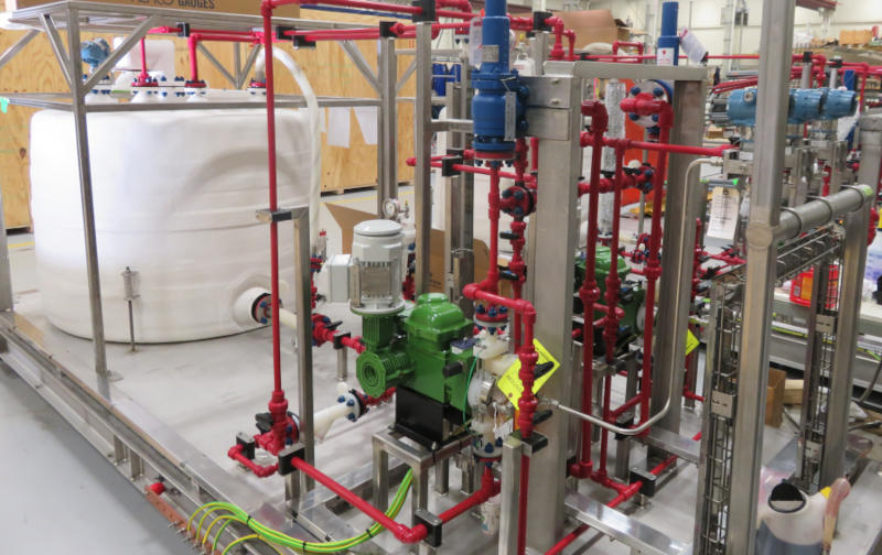

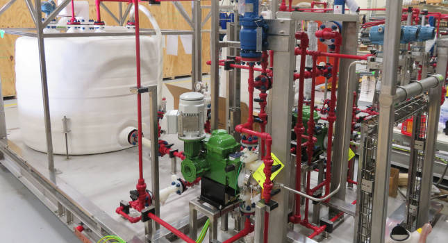

Over years of use, Kynar PVDF has proven excellence for sunlight resistance. In applications involving the combination of sunlight and chlorine, the addition of red pigment in the Kynar 700 PVDF extends the life of the piping by acting as a UV block to keep the contained chemical stable. The system, seen in Figure 2 shows a system engineered by AmeriChem Systems, Inc. using Red Kynar PVDF in all contact surfaces.
Figure 2: Example of Schedule 80 Red Kynar PVDF piping system designed to feed Sodium Hypochlorite. Courtesy: Plast-O-Matic Valves, Inc.
Figure 2: Example of Schedule 80 Red Kynar PVDF piping system designed to feed Sodium Hypochlorite. Courtesy: Americhem Systems

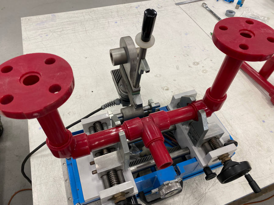

ASI has experience fabricating chemical piping delivery systems from one half inch (1/2”) to four inch (4”) diameter in Red Kynar PVDF. Choosing Schedule 80 thickness determined by iron pipe size (IPS) gives an extra degree of safety by having a thicker wall pipe than may be used in a general chemical environment. Figure 3 shows a red pipe socket fused to a fitting.
Figure 3: Socket fusion joining method commonly used for Red Kynar PVDF Schedule 80 pipe and fittings. Courtesy: Plast-O-Matic Valves, Inc.
Figure 3: Socket fusion joining method commonly used for Red Kynar PVDF Schedule 80 pipe and fittings. Courtesy: Americhem Systems
