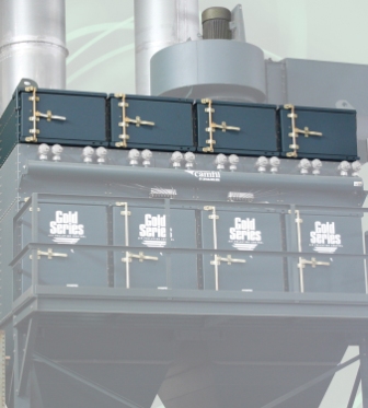

The Gold Series cartridge dust collector, with an optional feature for integrated HEPA safety monitoring filter, is designed to prevent collected dust from re-entering the workspace if there is a leak in the primary filtering system. Each module incorporates two HEPA filters capable of handling 2,500 cfm of air per filter and rated to remove 99.97% of airborne particles of 0.3 micron in diameter and larger.
The Gold Series’ integrated design maintains the after-filter at negative pressure, preventing contaminated air from escaping. The design allows access to the HEPA filters and easy change-out through the platform used to access the primary filters.
