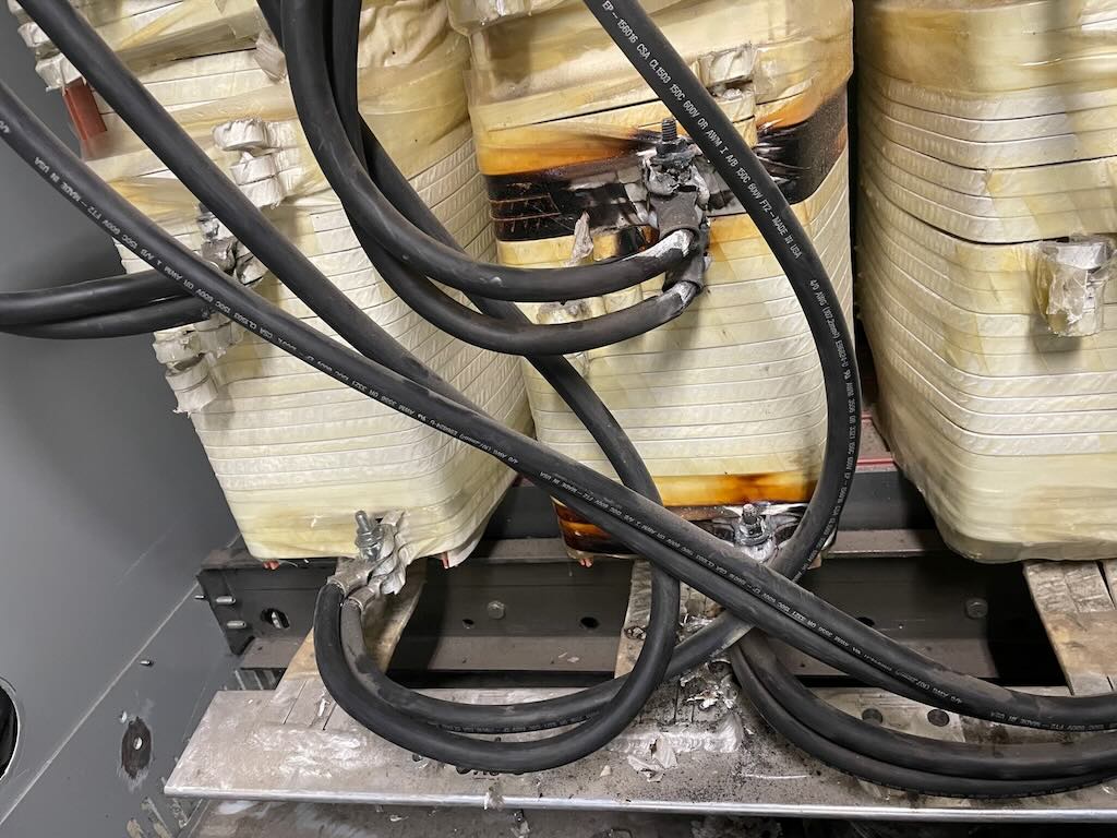

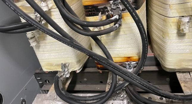

Remember, heat accumulation can degrade and lead to the failure of the transformer. In Figure 2, this point of degradation and failure at a connection point is very clear. The heat accumulation at the connection point far exceeded the 428°F temperature rating of the insulation system, causing insulation burning and transformer failure. The burned connection points in Figure 2 are one of the three transformer primary winding taps. The position of the taps can be arranged during the installation to best match the incoming power supply voltage.

Considering the nameplate of Figure 1, the primary voltage of 480 volts will pull from the incoming power supply 90.2 FLA per phase, much less than the secondary windings. Nevertheless, considering the same terminal resistance of 0.001 ohms, the resulting power will be 8 watts, much lower than the secondary, but still consuming power and generating heat.
Given that Figure 2 shows the primary taps, this connection must have been much higher than 0.001 ohms, perhaps in the several ohm range. For example, if the connection point resistance was 0.2 ohms, the resulting power dissipation would have been 1,627 watts — much hotter, which may have caused this burning and the insulation system failure.
Additionally, the low-resistance (milliohm) test can reveal any connections that have oxidized over time. The oxidation will increase the connection resistance (even if the connection torque is within range) resulting in higher temperatures at the connection points. Removing the oxidized connectors and removing/cleaning the oxidation before reinstalling the connectors will return the connection to its designed intent when reinstalled using the torque requirements of the manufacturer.

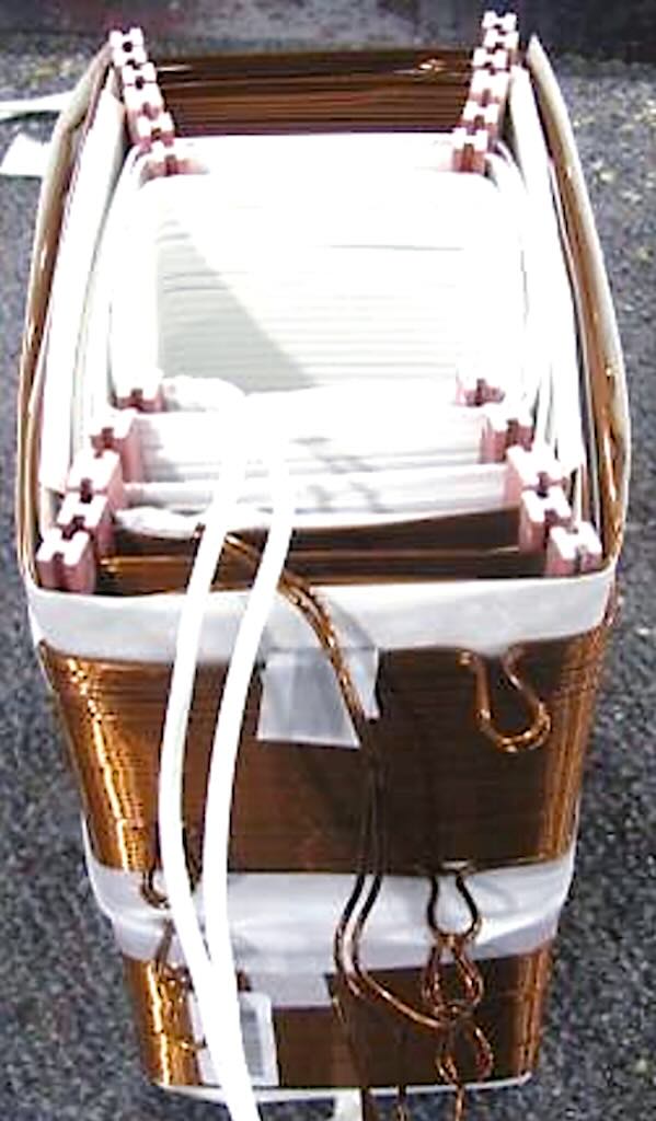

The NFPA 70B Chapter 11 recommends that LVDTTs be cleaned once per year. The accumulation of dust and dirt within the transformer will inhibit airflow through the transformer. LVDTTs are air-cooled electrical products (Class AA — see Figure 1 nameplate) and the cooling works by what is known as the “chimney effect” where cooler ambient air enters the bottom of the transformer and through convection, rises through the core and coil structure exiting through the top vents or openings.
Transformer core and coil design and construction adds planned ventilation by providing cooling ducts as shown in Figure 5. Over time, through the movement of air and temperature changes, these cooling ducts can get clogged with dust and dirt. To clean these ducts, the transformer must be de-energized and allowed to cool before lightly blowing in air and vacuuming out the accumulated dust and dirt. Depending on the installation environment, this service should be annually for environments known to have significant amounts of airborne dust and dirt or every few years in environments where the airborne particulates are known to be moderate or low.
