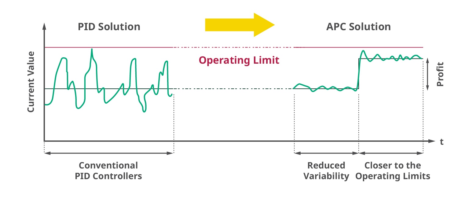

Figure 2: When embedded into the plant control system, advanced process control reduces variability todeliver better dynamic performance closer to operating limit.
Figure 2: When embedded into the plant control system, advanced process control reduces variability to deliver better dynamic performance closer to operating limit. Courtesy: Emerson
Not only does this built-in knowledge help operators make better decisions as they guide the plant through changing operational states, it also helps ensure that the plant’s best practices are applied every time, through every stage of a workflow, regardless of who is working in the control room. Operations teams are also linking these advanced control solutions with simulation software to build digital twin replicas of their power operations to test new operating strategies and improve training across the workforce for faster upskilling.
