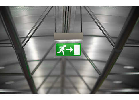

3. Evacuation routes and rally points
Evacuation routes must be clearly marked and wide enough to accommodate a large number of evacuating personnel. Ensure your exit routes are unlikely to expose employees to additional hazards. Without a clearly mapped route, employees may not know how to safely and quickly exit the building. Also, be sure to consider a special route for people with disabilities.
Additionally, identify rally points, or locations at which all employees should regroup after they’ve safely exited the building. The key to the evacuation process is to ensure everyone knows where to go, how to get there and how to stay together during the emergency.
