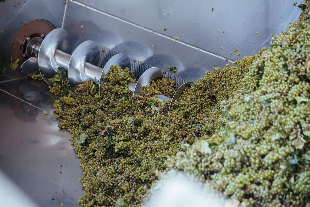

The team started with criticality. The crushing area of operations was critical to Gallo’s busy season, and historically, the maintenance and reliability team had overhauled all the stemming machines in that area before the season began each year. Whether machines needed maintenance or not, they would be stripped down and overhauled. The process was expensive and time consuming. Moreover, opening equipment that was operating optimally also risked introducing problems where there originally were none. This area of production was the perfect candidate for a pilot program (Figure 1).
Figure 1: Gallo's stemming and crushing machines are critical to operation. Continuous monitoring helps the team keep an eye on their health at all times so they can begin the busy season with confidence.
Figure 1: Gallo’s stemming and crushing machines are critical to operation. Continuous monitoring helps the team keep an eye on their health at all times so they can begin the busy season with confidence. Courtesy: Emerson
