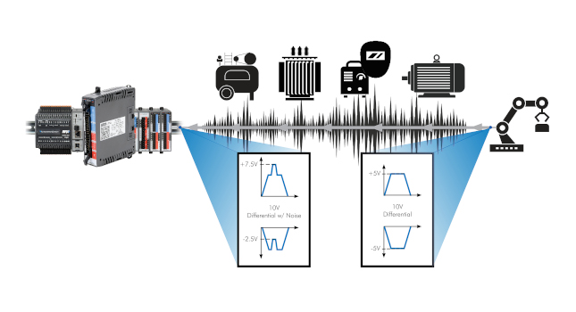

Designers can also select devices that offer additional built-in protections against the specific challenges faced in industrial environments, a major one being electrical noise. Standard single-ended PLC input/output (I/O) modules use the simplest and least expensive signaling method but may not operate as expected when there are nearby devices like welders, transformers, generators, and variable frequency motor drives creating large amounts of electrical noise. By choosing modules offering differential I/O, signal accuracy is safeguarded by cancelling out any electrical noise induced on the line in these high EMI environments (Figure 2).
