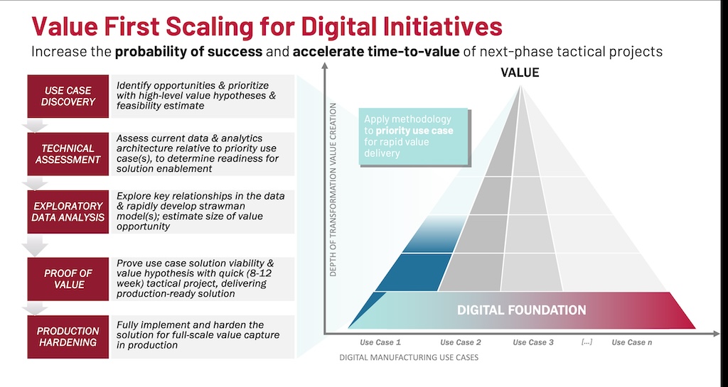

Increase the probability of success and access time-to-value of new-phase tactical projects.
Increase the probability of success and access time-to-value of new-phase tactical projects. Courtesy: Kalypso
By harnessing autonomous control strategies, organizations can develop robust models that integrate operator insights with knowledge gleaned from historical data to determine the necessary system adjustments for optimal results. With these advanced capabilities, AI is elevating the role of an operator from making repetitive manipulations to managing the performance of the machines.
Question: What key factors influence the return on investment (ROI) for plant automation projects?
Mithun Nagabhairava: As organizations are advancing their automation and digital capabilities, it is important to start with assessing the current level of performance across the manufacturing process. This would help to determine which areas are the most challenging and would provide the best opportunities to improve asset availability, optimize process consistency, enhance quality control, and reduce energy usage.
Leading organizations prioritize high-value use cases, demonstrating their worth through limited deployments and devising strategic plans for scalable implementation.
