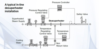

Effective desuperheater design
Most all desuperheaters work on the same principle of operation; cooling water is brought into contact with the superheated steam so that it evaporates and ultimately cools the steam to a temperature closer to the saturation point. While a desuperheater is capable of cooling down to the system saturation temperature, typically they are designed to produce outlet steam temperature 5 – 10 °F above that point. This design effectively limits the amount of condensate that is created and must be removed. The amount of residual superheat left in the output steam needs to be determined by process requirements.

Use the correct componentsThe desuperheater itself is only one component within a correctly designed system. It is common to have ten or more individual components in the system that all work together! So it is easy to see why systems engineering and understanding how the system components interact are paramount to efficient performance. An inlet steam control valve with pressure controller, cooling water control valve and temperature controller, temperature sensing element, piping, and desuperheater are all commonly used components within a desuperheating station which must work together.
A typical mistake that is made in component selection is the under sizing or oversizing of control valves. For example, if a desuperheating station is designed for a 30:1 steam flow turndown, its associated steam control valve must be sized to closely match this flow. If a control valve with a 20:1 turndown is used, it will not allow the system to work properly. Steam temperatures may never be reached as well.
