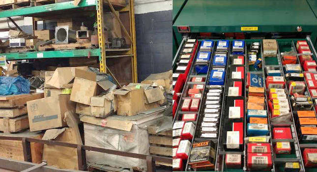

Organization and identification is everything
We should never walk through a parts storage area and find a part not physically identified as either an inventory item or a non-inventory item. Either the item is being stored in an established and labeled inventory location, or the item is tagged with a 3” x 5” tag stating what the item is and why it is there.
When items are received, each is identified as an inventory or non-inventory item. Based on their category, place the items in their correct locations.
Typically, the majority of received goods are inventory items and when they are being received into the CMMS, a computer-generated 1” x 3” bar code label for each item is printed and attached to the item (if the item is large enough for a label). Then the items are to be taken to their inventory locations and put into place.
Non-inventory items are typically for work order (WO) completions and projects. These items need to be grouped and placed in boxes to keep all the parts together for each WO. WO numbers should be written on the outside of the boxes in large letters and numbers for easy recognition. Choose a specific location to store the WO boxes so everyone knows where to verify if all items have been received for each WO. Usually, these locations are small metal shelving units.
Create a specific location established for temporary storage of items that need to be shipped out of the plant. The shipping reasons could be wrong items shipped in for a PO, items damaged in shipments and items being shipped out for repair or warranty replacement. When any item falls into one of these groups, securely with a wire tie or small wire, attach a 3” X 5” paper tag to the item and/or storage box to identify the item. The tag must include the item description, part number, the relative PO # and explain why it’s in this location. An example of a typical tag would read: “Part # XYZ123, PO #ABC789 Return to Vendor, Damaged in Shipment”.
Take appropriate action with the purchaser to get the items shipped out ASAP. No item should sit in this location for longer than (4) days or the location will turn into a large stockpile of mixed-up items that takes up valuable floor and shelf space.
You may encounter items in some storage locations that are not inventoried stock items. These items may be ‘just in-case we need them’ items. They are not items to keep in your inventory’s on-hand balance in inventory or items for which you need to track usage. These items will not be in the computer system and will not have computer generated labels on them. However, everything in a storeroom should have some form of identification so everyone knows what it is and where it is used. For non-inventoried items, a 3” x 5” tag should be filled out with the item identification information on it and attached to the item (or to the storage location if they are very small parts). These non-inventoried items do not need to be scanned out of the storeroom. Just take them as needed.
Very large inventoried items should be stored in the main storeroom and remote storage locations. Each inventory item will be labeled with a peel and stick computer generated bar code identification label, typically 1” x 3”. On each label is the description of the item, the item part number, a bar code unique to each item and its storage location.
Small items are placed in cabinet drawers or in plastic bins on storage racks with each type of item isolated in individual pockets within the drawers and plastic bins. The barcode label should be placed on the location dividers, behind the parts in that location, in each cabinet drawer or on the plastic bin dividers and not on the part itself.
For larger items on rack shelves, the tags can be placed on the item or the box containing the item. These ‘tags’ can be pieces of 8-1/2” x 11” paper or cardboard with large lettering so they can be read from floor level if the items are stored high on pallet racks.
For larger items stored on pallet racks, if it’s not practical to place a label on the item or box, a 3” x 5” paper tag should be firmly attached to the item or box and the bar code label placed on the tag.
Most items are stored with ‘like’ items – but not always due to storage space restrictions. Always look for the item first in the computer CMMS first to determine the exact location(s) of the part, which saves time physically looking for it. The worker may discover the item may be in several different storage locations across the plant. This is important because if the quantity of the item is zero in one storeroom location, there may be identical items in a remote storage location.
