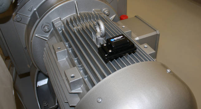

Organizations can now deploy smart sensors onto critical assets and utilize continuous vibration and/or temperature monitoring to watch trends and trigger alerts when irregular thresholds are met. For example, wireless sensors can be deployed onto motors and rotating equipment to monitor vibration and temperature. The sensors interpret this data and alert maintenance teams when anomalous behavior is detected. This early warning into an impending equipment failure allows maintenance teams to proactively react as opposed to running to a failure that wasn’t predicted.
