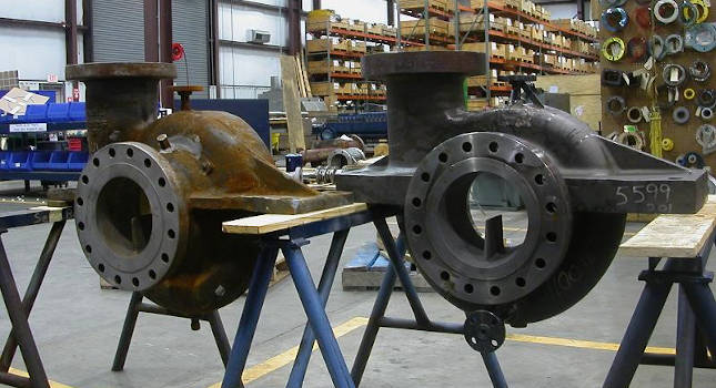

Equipment that was purchased and installed prior to the implementation of modern industry specifications may be lacking in the ability to handle external nozzle forces and moments imposed by the connected piping. These forces, when applied in excess, can cause the pump case and / or base to deform, attributing to misalignment, excessive vibration, and potentially wear part contact. Often, these pumps were designed with thin mounting feet, minimal webbing bracing, and flanges that were flat faced and rated for 150 or 300 psi (10 or 20 bar). These configurations can be upgraded with proper modifications to the existing patterns while maintaining the ability to fit in the existing piping and baseplate installations.
Legacy mounting feet and webbing may be one inch thick or even less, depending on the original design. Newer style API-610 compliant pumps are supplied with much thicker feet and webbing to support API-610 nozzle loading requirements. Figure 2 depicts pattern alterations that have been made to a legacy design to improve the overall stiffness of the pump.
As can be seen in Figure 2, the mounting foot thickness has more than doubled, providing extra strength to the casting. The web bracing from the foot to the volute outside walls has also increased in thickness. In addition to these changes, the flanges for this case were changed from the original American National Standards Institute (ANSI) 300# Raised Face design to an ANSI 600# thickness with the same drilling and machining dimensions of the original 300# flanges. All these modifications have helped to improve the overall resistance of the case to deflect in the presence of pipe strain or increase the overall allowance of pipe strain as it relates to the pump alignment.
The final upgrade implemented for this case to improve overall stiffness of the pump and case connections was the installation of gusseting on the vent and drain flanges. Adding the gussets reduces the chance of small-bore pipe weld failures due to vibration fatigue.
