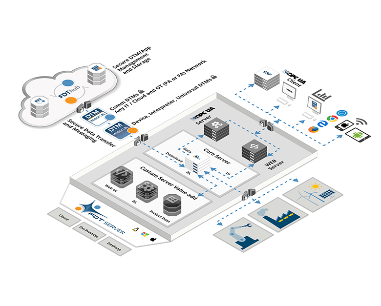

Figure 1: FDT Server architecture supporting smart manufacturing and maintenance practices. Courtesy: FDT Group
DTMs can integrate any protocol, device/type/data model (common and device-specific parameters) and information model – a big advantage when talking about creating a unified environment that can support and sustain a reliability and maintenance-centered application across IT and OT teams in the enterprise.
Investment in data-centric technologies and standards such as FDT improve maintenance practices and workflows for end users, impact production capabilities, and improve manufacturing efficiencies and sustainability by preventing unplanned shutdowns, reducing downtime, and lowering maintenance costs – all providing significant financial benefits.

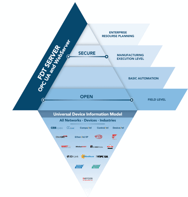

Figure 2: The FDT Server solution encompasses a Universal Device Information Model for seamless integration and communication enhancing monitoring and optimization practices. Courtesy: FDT Group
