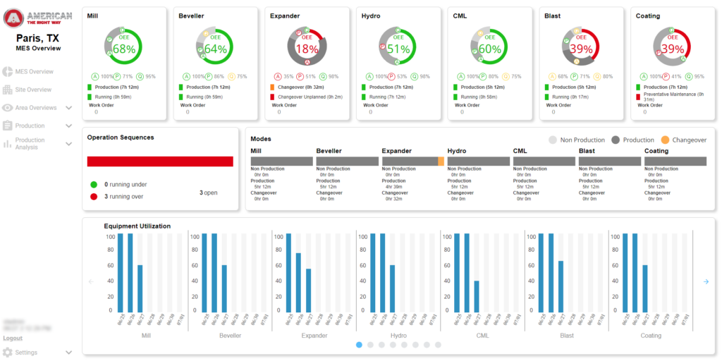

The MES Overview displays critical information for all core production lines during the shift. It reports equipment utilization as well as OEE, production status, work order information, and time spent for each core line. Note: Screenshot is simulated and does not represent actual process data. Courtesy: Vertech

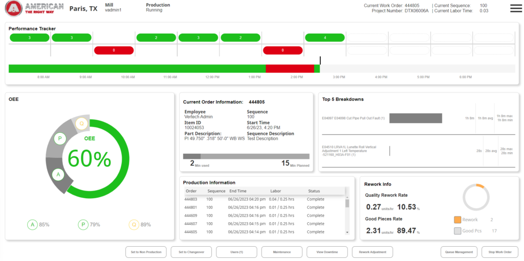

The Mill Overview gives the operator a production overview for that shift. The header displays the current line state, mode, and work order information. The Performance Tracker card shows the status and performance of the line in an hour-by-hour breakdown. The OEE Gauge on the left shows the breakdown of OEE and the contributing variable percentages: Availability, Performance, and Quality. The Current Order Information card shows the active order and operation sequence and the total active time spent on the sequence. The Production Information card shows all orders and their runtime information for the current shift. The Top 5 Breakdowns card shows the accumulated top five downtimes for the current shift and the average, minimum and maximum downtime for the specific downtime reason. Courtesy: Vertech

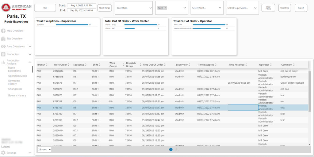

The Route Exceptions Report displays any work order sequences that are out of order as well as resolution time, exception time and other relevant information. When a downstream operation is run before all previous operation sequences have been completed, each incomplete or skipped operation sequence is added to an out-of-order log. These out-of-order operations can be resolved by completing the operation, or a supervisor can mark the route as excepted. When marking an exception, the supervisor can note why the route is excepted. Courtesy: Vertech
