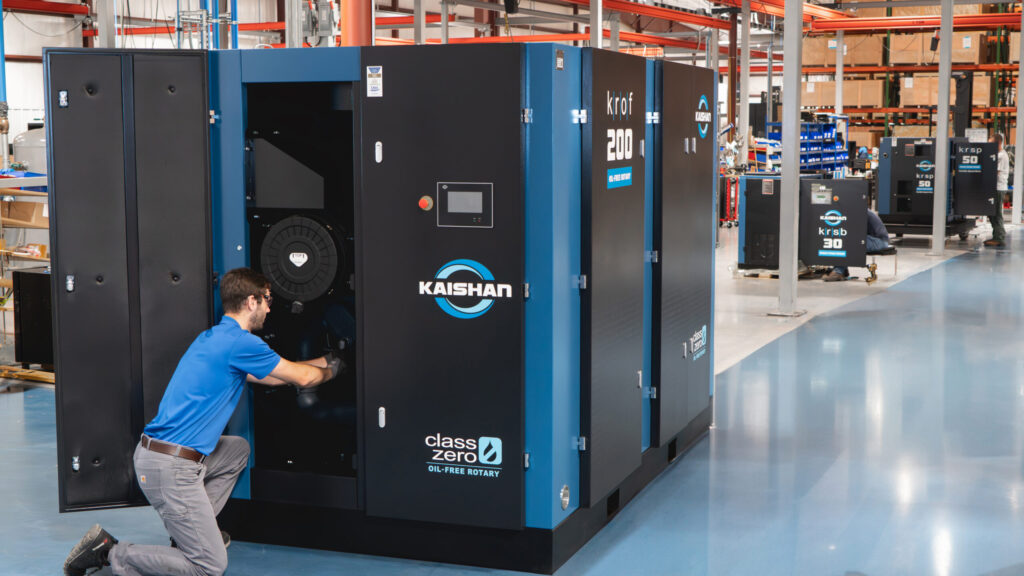

Question: Foaming on oil lubricated machine usually causes what?
Answer: Mixing of non-compatible lubricants is a common cause. Always check with your supplier on mixing lubricants. Usually, it’s best to fluid the system and change all the filters. Then use new lubricant and filters when changing.

Question: Why wouldn’t you always use a desiccant-type air dryer?
Answer: Desiccant dryers give you an excellent dew point but consume a great deal of energy. Due to the high cost of ownership, you should only consider where needed.

Question: What changes on the oil injected compressor when using a food grade lubricant versus a standard lubricant?
Answer: Typically, the lubricant doesn’t last as long and you’ll have more frequent maintenance.

Question: Curious about the comment about food grade lubricant lasting 2x as long in an oil injected machine.
Answer: It’s the other way around—usually OEM lubricants are rated for 8,000 hours while food grade lubes are commonly replaced at 4,000 hours.
