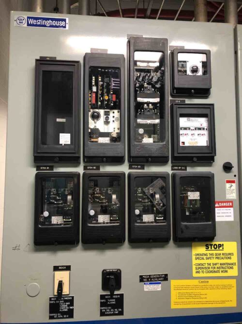

Off-site wiring, uploading settings and testing relays: It is recommended wiring relays and their associated test switches to the relay doors or insert panels off-site. Another good practice is to upload relay settings, test relay elements and logic off-site. This reduces the outage duration in the field and helps accomplish milestones in the upgrade process.
Reducing outages is one of the important factors in the relay upgrade process. Not being able to schedule an outage is one of the hindering factors on relay upgrade projects. Relays are a huge part of the power system automation and protection. Thus, any facility can only afford to have minimal downtime involving them.
Figure 2: These images are the before (left) and after pictures of the medium-voltage switchgear after relay upgrade work has been performed. Courtesy: National Field Services
Medium-voltage systems will be without any protection and automation features if relays are safely taken out of the service. This could compromise the reliability and safety of the power system. Many relay upgrade projects are postponed or suspended because of the lack of switchgear shutdown or inability of any facility to schedule the outage.
On-site demo, install, test and commission: The final and most important step in relay upgrade project is bringing everything together in the form of a field installation. It is always recommended documenting all existing wires and maintaining integrity and aesthetic property of wires in compartment while wiring.
Another important final step is commissioning the entire system. This includes at minimum verifying polarities, current transformer (CT) ratios, phase rotation and direct current trip checks to list a few. The goal is to improve the system reliability and safety without any nuisance power interruptions. Those calculations should be redone and documented at this time. It is imperative to have detailed plans and procedures for existing system uninstallation, new relay installation, testing and commissioning, contingency plans for unexpected surprises during this entire upgrade process (see Figure 2).
