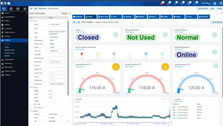

Figure 2: Digital equipment monitoring provides real-time and historical insight into electrical and mechanical systems to help plant management teams keep a close eye on equipment performance and environmental conditions. Courtesy: Eaton
1. Monitoring equipment: sensors as digital watchdogs
Watching for problems in electrical and mechanical systems is important and digital monitoring provides a powerful tool to understand assets and environmental conditions. Digitalization allows this to be accomplished safely without exposure to equipment or environment — reducing risk and providing insights on changes to conditions and equipment performance.
Further, digital equipment monitoring helps reduce complexity and risk. Complicated repairs create added risk exposure and typically have greater potential for injury. For example, hoisting is a dangerous process from an environmental health and safety perspective.
However, if an electric motor can be repaired early because of motor health predictions from motor analytics software or health-related warnings from an intelligent motor starter, it may be a simpler repair. Otherwise, if a motor fails, it will likely need to be hoisted out for replacement. In other words, having information as a situation develops can help reduce the risk of injury.
