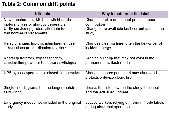

Understanding label drift
Arc-flash labels usually lose reliability through ordinary plant activity, not obvious neglect. A transformer is replaced, a relay setting is adjusted, a rental generator is connected or a UPS bypass remains in service longer than planned. Each change may look manageable by itself, but any one of them can affect available fault current, clearing time, source path or protective device coordination.
That is why arc-flash risk assessments should not be treated as permanent records. They need review when major electrical modifications occur and should be periodically reviewed even when no obvious change has been documented. The label can become outdated the day after it is installed if the electrical lineup changes enough to invalidate the study assumptions.
A multisource arc-flash program also fails when ownership is vague. Plants should assign clear authority for decisions that can change the arc-flash basis, including:
  • Approving closed-tie operation
  • Placing equipment in UPS bypass
  • Connecting rental generators or temporary feeds
  • Changing relay settings, trip units, fuse types or maintenance switches
  • Releasing work based on a mode-specific arc-flash label
  • Deciding when engineering review is required before energized work proceeds
Without assigned ownership, “verify the label” becomes a slogan instead of a control. A configuration-control process should answer three questions before work begins: which electrical lineup is active, which study case applies and whether the field label is valid for that operating mode.
