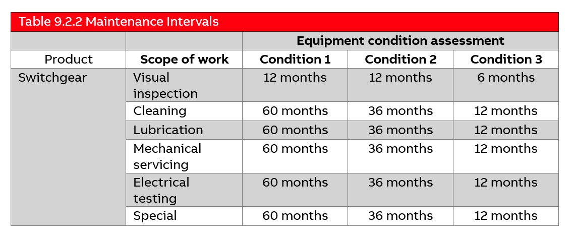

The 2023 revision, which converted the previously published guide to a standard, provides detailed installation and operating condition-based maintenance intervals for many common types of electrical equipment. The condition assessment of the equipment is critically important to the EMP and, ultimately, to the total cost of ownership. The document defines three types of equipment conditions, with the highest of the three categories driving the maintenance interval per NFPA 70B, Sections 9.3.1, 9.3.2 and 9.3.3:
  • Equipment physical condition.
  • Criticality.
  • Operating environment.
In addition to guidance on when the maintenance interval should occur, the standard details when system studies should occur, the content of the maintenance work scope and the type of testing that is approved (NFPA 70B, Chapter 6, Chapters 11 through 36 and Chapters 7 and 8, respectively).

Table 1: An example of preventive maintenance intervals created using NFPA 70B-2023 Table 9.2.2 guidelines for equipment conditions. Courtesy: ABB Electrification Service
