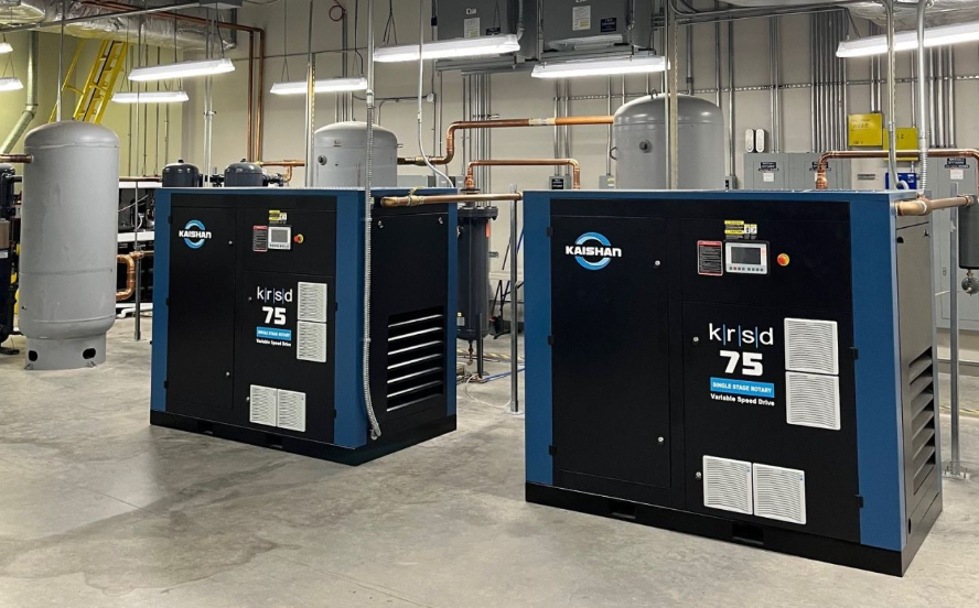

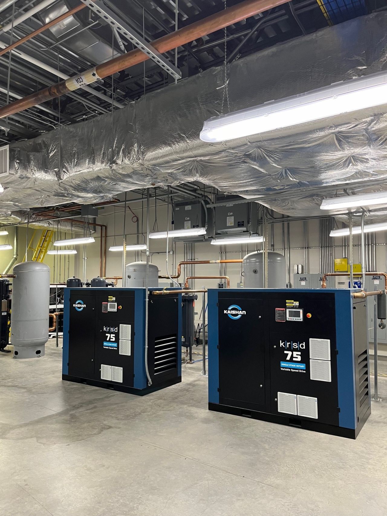

Figure 1: This compressor installation by Texas Compression Services shows a backup compressor and ample storage, both critical factors in improving manufacturing uptime and reducing energy costs. Courtesy: Kaishan USA

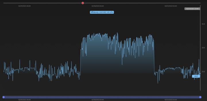

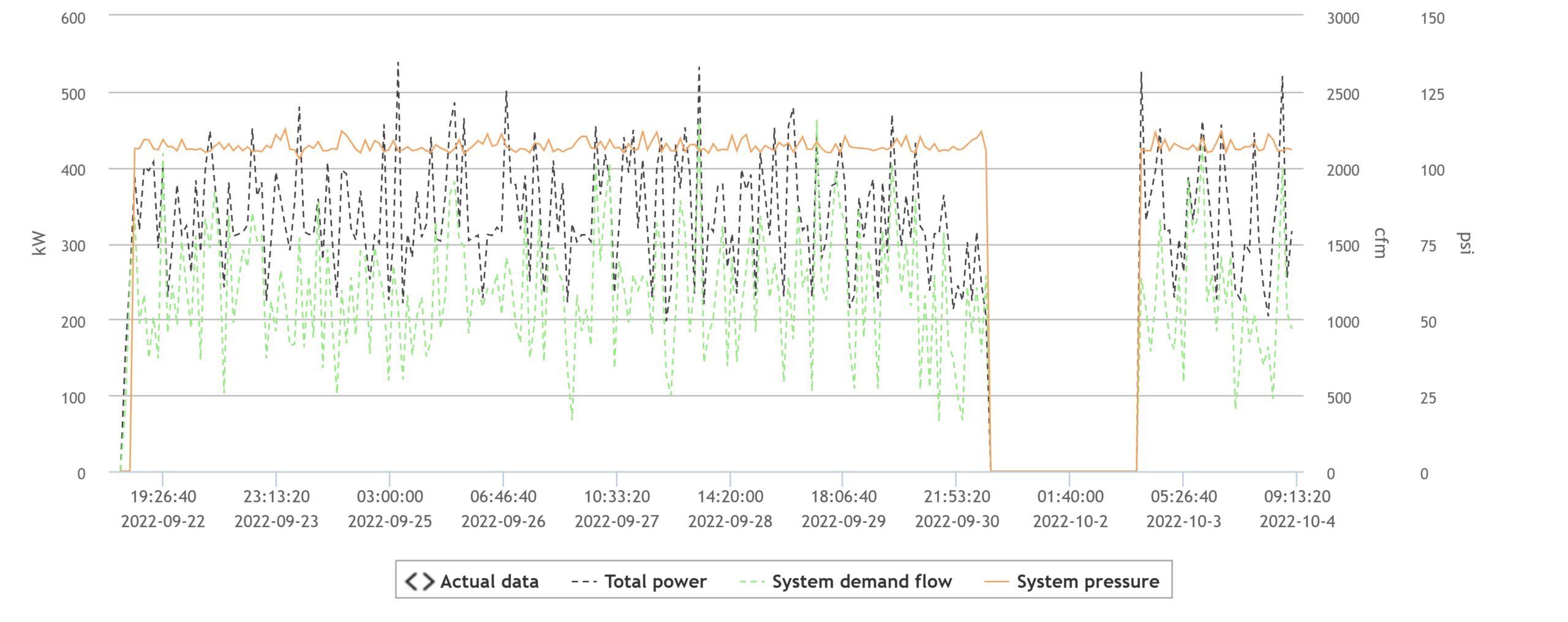

Figure 2: Most operators run their compressed air system (orange line at top) much higher than system demand (green line). Most systems can be held to +/- 2  pounds per square inch gauge (psig) with proper storage and control. In this case, system pressure appears to be about 25 psig more than demand. Courtesy: Kaishan USA

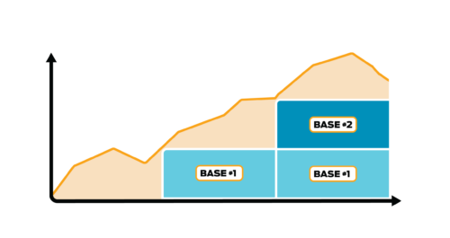

Figure 3: This graph of a system’s efficiency shows the impact of a master controller as it turned on (left side), turned off (center) then turned back on again. Courtesy: Kaishan USA

The ideal is to have all your units arranged in a three-compressor configuration. In a three-compressor configuration, your compressors are organized as follows:
  • A base load compressor is sized to meet your system’s minimum compressed air load. Its output does not change as demand varies. It runs full bore, or it is turned off. Depending on your demand profile, you may choose to have more than one base load unit.
  • A trim unit kicks on when the demand rises above the minimum load. Designed and sized to meet changing demand, your trim compressor should be the unit best at running at partial loads. That usually means trim units are rotary screw air compressors equipped with variable-speed drives.
  • A backup should be in place to provide airflow when a base or trim unit goes offline. It should be sized the same as the base load equipment to effectively meet all system needs.
The goal of a three-compressor configuration is to eliminate the possibility of unplanned downtime (see Figure 4).

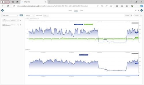

Figure 5: This audit by a compressed air professional documents a compressor’s air pressure and power consumption over a week. Courtesy: Kaishan USA
