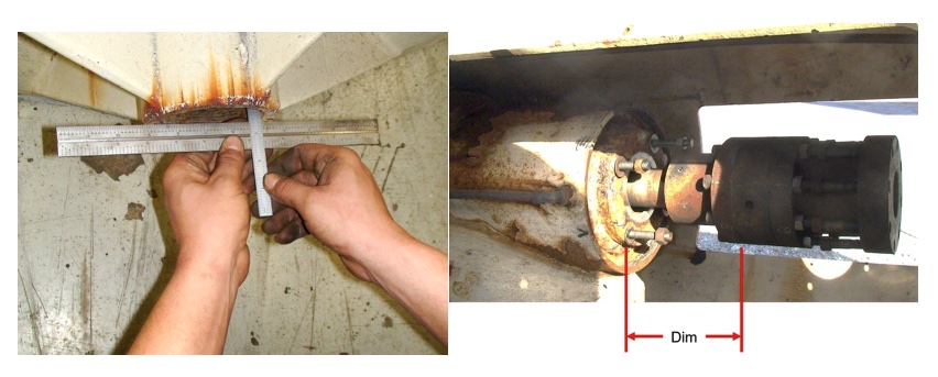

Shaft position. Measure the shaft position bottom and top before disassembling the pump (Figure 1) and then replicate those dimensions during reassembly. If the pump is laying horizontal, be sure to push the shaft to the full bottom position with the impeller bottom setting on the bowl. Many impellers mount with tapered collets that must be in the correct location on the shaft. Otherwise, the shaft extension dimension will not fit the coupling and driver.
Figure 1: Measure the shaft position before disassembling the pump. Courtesy: EASA

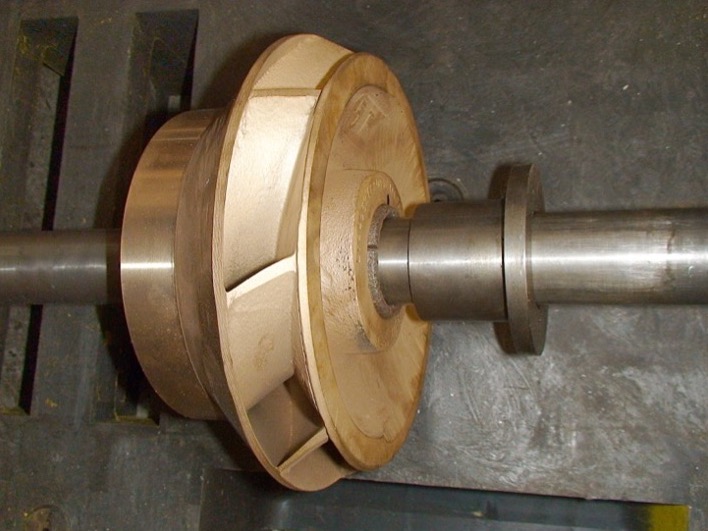

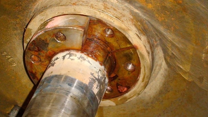

Top-down or bottom-up? Some VTPs secure impellers to the shaft with annular keys that fit into annular keyways in the shaft. The keys will be bolted to the top of the impellers, so disassembly must be from the top-down to access the annular key bolts (Figure 2).
Figure 2: An annular key mounted impeller. Courtesy: EASA
But most VTPs secure impellers to the shaft by driving tapered collets into them from the top with a collet driver. To disassemble these pumps, drive the collets up out of the impeller from the bottom with the same collet driver. Therefore, disassembly will be from the bottom-up. While it is possible to disassemble these pumps from the top-down by driving the impeller down off the collets, many service centers find this more difficult.
Figure 3: A tapered collet mounted impeller with collet driver. Courtesy: EASA

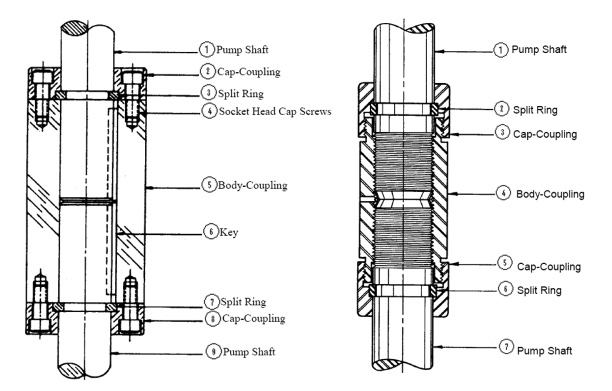

Caution: A few coupling designs are more sophisticated than simple threaded couplings (Figure 5). These are expensive, so don’t cut them with a torch.
Figure 5: Examples of special couplings. Courtesy: EASA

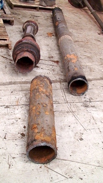

Threaded shaft-enclosing tube and column sections. When these sections are threaded together, they can be hard to loosen if corroded or frozen. These sections of pipe are not difficult to replace, so cutting them with a torch may be an easier “disassembly” method (Figure 6). Vendors have common pipe sizes that require cutting threads on each end.
Figure 6: This shaft-enclosing tube had to be cut in pieces due to severely corroded threads. Courtesy: EASA

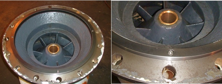

Static components. Many static VTP components with corrosion damage can be repaired by welding, coating or a combination of the two. For example, metal repair epoxy compounds can be troweled in place to cover and repair corrosion damage. Corroded or damaged rabbet fits between bowl sections and column sections must be machined true to ensure proper bearing alignment. When the radii are corroded or damaged, it may be necessary to machine off the male fit and install a ring to repair the damage (Figure 7). The perpendicularity can be corrected by facing off rabbets.
Caution: If impellers mount with annular keys, the keyways on the new shaft must be adjusted to fit refaced bowl sections.
Figure 7: A ring was machined to replace this damaged male rabbet. Courtesy: EASA

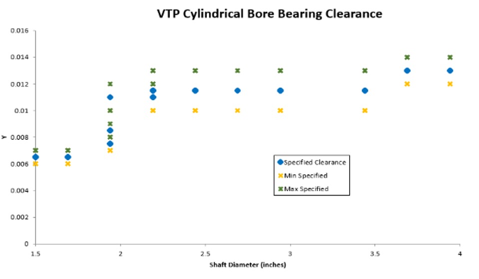

Shaft-to-bearing clearance: A common question about replacing line shaft and bowl bearings is, “What is the proper clearance between the shaft and bearing bore?” For horizontal machines, there are various “rules of thumb” for calculating bearing clearance, typically using a set amount plus an adder for each inch of shaft diameter (e.g., 0.003” + 0.002”/in of shaft diameter).

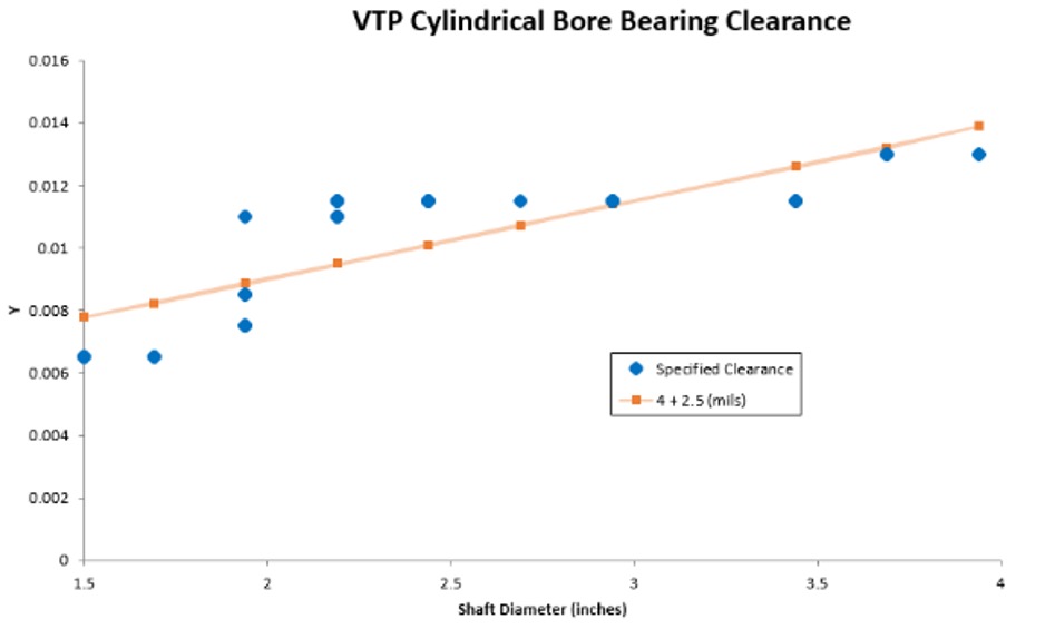

However, vertical bearings have no steady radial load against which to develop a hydraulic lifting force. In fact, review of some VTP manufacturers’ data indicates a wide range of values that don’t track directly by shaft size. The best available guidance is statistical analysis of data providing clearance “guestimates” based on linear regression analysis models (Figures 8 and 9).
Figure 8: Statistical analysis of VTP manufacturer bearing clearances. Courtesy: EASA
Figure 9: Linear regression analysis model “guestimates” for VTP bearing clearances. Courtesy: EASA
Factors that affect whether a particular pump should have closer or looser bearing clearances include how straight the line shaft is, how true on center the bearings are bored (considering variation from column joint runouts), the rotating speed, and the type of pumpage. Higher speeds, truer bearing bores and straighter shafts argue for closer clearances, and conversely for looser clearances. When considering these factors, the statistical analysis results can still be helpful.
