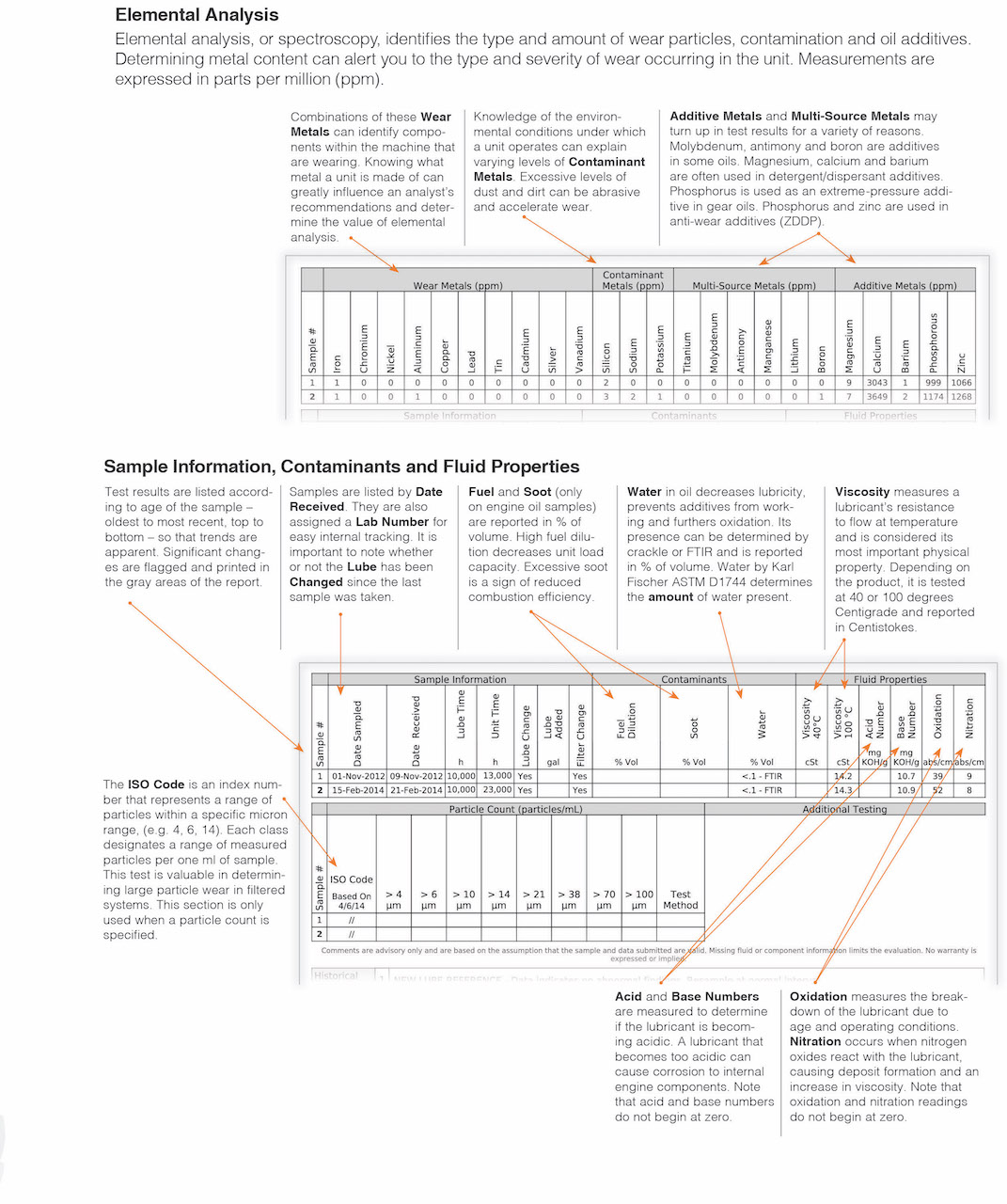

First, look at the laboratory report’s equipment information provided to the lab via the sample label. This will, or should, provide the unit number, the component of what piece of equipment was sampled, the oil used, the hours on the equipment and the oil and if a filter was changed.
The fluid analysis results provide information in three critical areas: the oil’s physical and chemical health, the equipment wear analysis and the contamination levels.

The first result to look at is the viscosity. It is the most important characteristic of the oil. If the viscosity is not in the range of the oil identified for the sample, the cause needs to be determined. Was the wrong oil listed on the oil sample bottle, or was the wrong oil put into the unit sampled? If the wrong oil was used in the unit, it is critical the oil is drained and the right oil used immediately. If the wrong oil was listed on the sample and the lab flagged the viscosity abnormal, but the viscosity result is correct for the unit, make certain that the data on the label is correct for the next sample.

Another chemical oil analysis result to review is the lubricant metallic additives. Although, the metallic additive levels generally do not change with use because as the additive is activated or used, the metal still remains in the oil. It is still good to note the levels of zinc, magnesium, calcium, phosphorus and other metallic additives to know that the right oil is used or that it is not contaminated with another oil. Magnesium and calcium are common detergent additives in engine oils but are not typically found in industrial oils.

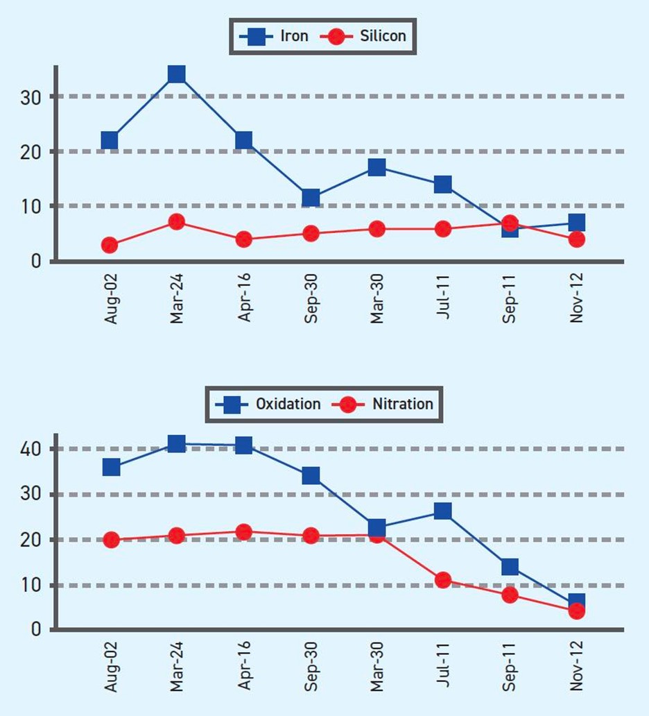

Equipment wear metals vary greatly with equipment and components, but the common wear metals to watch are iron, chromium, nickel, aluminum, copper, lead, tin and silver. The idea here is to monitor trends in wear metals in a component’s oil analysis results. So long as the results are drawn from the same spot in the component at the same number of operating hours, a relatively flat line graphing wear level is normal. A sudden spike in a wear metal may be reason to investigate the root cause. If, however, a spike in iron wear in a gearbox is noted, but the oil drain interval was double the time of previous samplings, the spike in iron may not be a concern. The wear may be normal for twice the operating time for the oil charge. Also, if it is only one wear metal for one sample, another sample would likely be the best follow up step. But, if wear metal results spike in conjunction with other wear metals or other abnormalities, corrective action may be warranted.
As an example, a rise in silicon indicative of dirt contamination is associated with an increase in iron wear; system filters, air and oil should be checked as well as any reservoir caps to make sure they seal properly and are in place. In the case of a diesel engine, a rise in silicon and iron accompanied with an increase in chromium is usually an indication of air filter leak allowing dirt to enter the engine combustion chamber causing wear on the chromium coated rings and iron cylinder. Engine bearings may have lead, aluminum, tin and copper along with iron, and so a rise in these wear metals along with an increase in AN may indicate corrosion taking place.

Figure 2: Oil analysis trending. Courtesy: AMSOIL INC./Oil Analyzers Inc/STLE
A good preventive maintenance program benefits from a quality oil analysis program, consisting of a series of evenly spaced representative used oil samples versus a one-time sample of a unit, followed by analysis interpretation of trends in the data and then quick corrective action. A single sample may help detect an engine “killer” such as a coolant leak, fuel dilution or high soot before the engine fails, but the timing required to catch these engine “killers” before failure usually relies on good luck.
