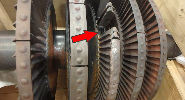

Example case study: Axial-flow expander locking blade failure
The locking pin for a blade in the third stage of an axial-flow hot gas expander rotor had failed. The failure analysis was undertaken to determine the basis for the design and establish the cause of the failure.
Figure 4: Locking pin hole material deformation. Courtesy: Sulzer[/caption]
The initial findings pointed towards ductile failure of the locking pin, therefore, additional steps were taken to determine the underlying reasons for such a failure. Metallurgical evaluation of the remaining portions of the locking pin was performed.
During examination of the fracture surface under SEM, significant deformation was found at the suspected crack initiation locations for the bottom pin at both high and low pressure sides of the disk. Initiation locations are indicated by red arrows in figure 5.

By means of FEA, the safety factor for the pins is equal to 1.3 at 115 percent of MCOS, which, in general, appeared to be marginally sufficient. However, based on conversations with the plant personnel it was found that this unit may have experienced some temperature excursions and possible over-speeding beyond 115 percent of MCOS during its service.
Therefore, in order to improve the design, the following modifications were recommended. Firstly, upgrade the pin material to 422SS with hardness ranging from 42 to 48 HRC. This will provide an increase in yield strength to 130 ksi during service, and, correspondingly, increase the shear strength of the material.
Secondly, it was proposed to further increase the safety factor by employing a locking block design in lieu of the locking blade. Reduction of the mass carried by the locking pins will positively affect its safety factor and provide an additional assurance that the repetitive failures would be avoided.
Modifications were implemented to the expander design, but no further service history has been reported for the subject rotor to the date.
