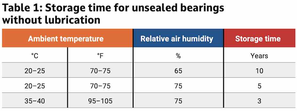

Bearings: From the start, proper storage is critical. Bearings should always be stored in a clean, temperature-controlled, low-humidity environment free of dust, shocks and vibrations. Many top bearing manufacturers coat them with a preservative oil film to protect against corrosion. Long-term storage times can be achieved by storing bearings in their original, unopened factory packaging.
To maximize the bearing’s operating life, use the “first in, first out” inventory policy. If a bearing is open (unsealed and not lubricated), bearings can be stored for up to 10 years without compromising service life (see Table 1).
For capped bearings (bearings with seals or shields), the storage time is limited by the lubricants and should be stored for a maximum of three years to avoid degradation of the grease fill.

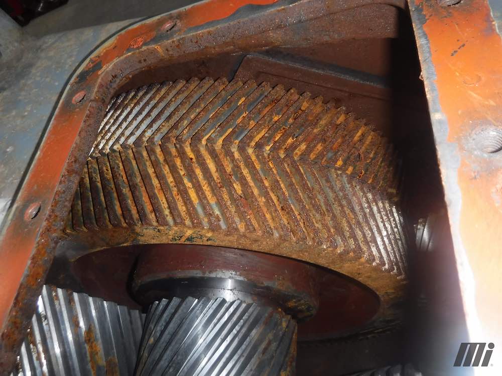

Gear reducers: Storage location is also the primary consideration for a gearbox. As directed for bearings in general, store the gearbox in a place free of ground vibration from sources like heavy equipment (e.g., vehicles, large forklifts, cranes) or railway activity. While stationary, rotating elements do not have a sufficient film layer between the metallic surfaces, vibrations can cause false brinelling from rollers oscillating against the raceways.
False brinelling is a recipe for failure. To further deter bearing damage, the shafts of gear reducers should be rotated a couple of full rotations every two months to distribute the lubrication film and prevent false brinelling and fretting corrosion. Tag the reducers, noting the storage date of the scheduled rotations, then ensure someone is responsible for keeping them on schedule.

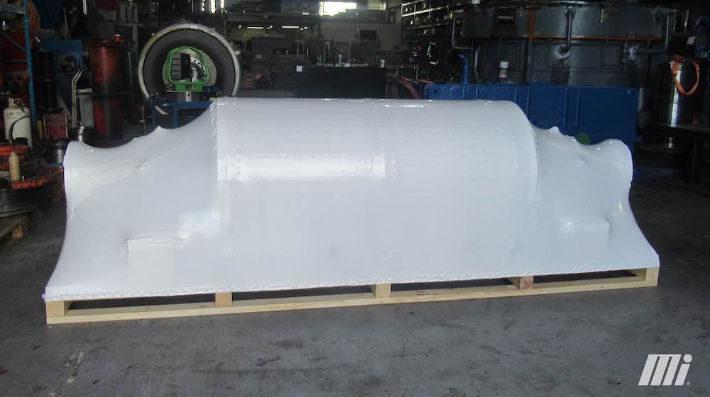

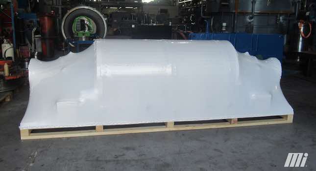

Seals can be coated with bearing grease to protect them from ultraviolet (UV) damage and contaminants. A high-strength polyethylene resin with UV stabilizers should then be sealed around the exterior housing to protect the ferrous metal of the gearbox from corrosion.Desiccant should be stored under the cover with the gearbox and replaced periodically.
Often, spare gearboxes will not be put into service for 5-10 years, so it is highly recommended to order a gearbox from the distributor/factory with long-term storage preparations included. Long-term storage packages consist of all the foregoing preparations. A properly treated gearbox — with a suitable location and periodic shaft rotations — should be in like-new condition and ready for service when needed.
