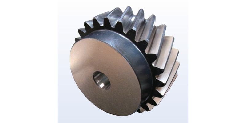

The helical gear configuration provides higher load carrying capacity than spur gears. The helical gear teeth are not parallel to the shaft, which continually engages multiple teeth, thus the higher load capacity. This configuration generates smoother power transmission with less noise than spur gears.
Helical gears are often used in parallel axis gearing such as automotive transmissions and large industrial gearboxes. Because the helical gear teeth are at an angle to the axle, or gear shaft, they do generate axial thrust putting added stress on gear shaft bearings. Heavily loaded helical gearsets may require the use of thrust bearings in the gearbox to counter the axial load.
