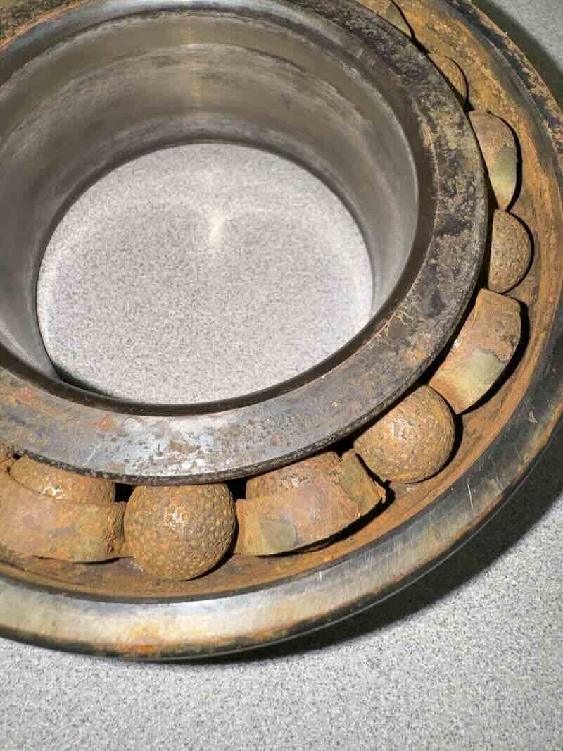

Humid and submerged environments pose several challenges to bearings, including corrosion, lubrication breakdown and increased friction. Corrosion can lead to premature bearing failure and increased maintenance costs and down time. Therefore, it becomes imperative to adopt proactive measures to counteract these challenges.
Figure 1: Secondary clarifiers main gear drive bearing. Courtesy: Upper Occoquan Service Authority

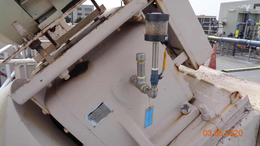

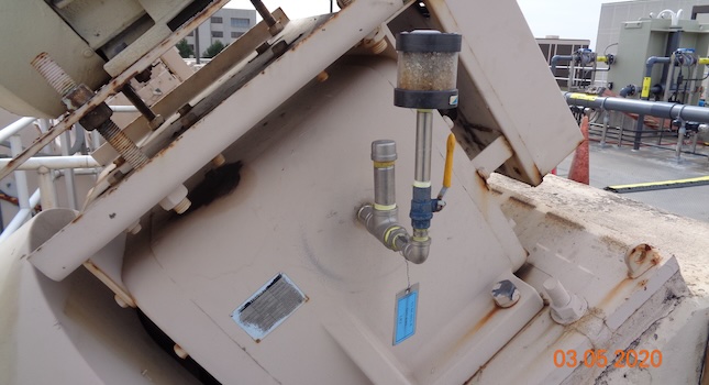

Desiccant breathers are intricate devices installed on machines preventing two critical contaminants: moisture and particles. To Understand what a desiccant breather is, it’s essential to understand the concept of a desiccant. A desiccant is a hygroscopic substance that attracts and retains water molecules, maintaining a dry environment. Common examples include silica gel found in packets.
Equipment such as gearboxes, pumps and reservoirs require proper “breathing” when air in the headspace expands and contracts due to temperature fluctuations or oil level changes in hydraulic systems. Each breath introduces dirt, debris and moisture, contaminating the lubricant and causing gradual equipment damage. Recognizing that a significant portion of lubricant contamination originates externally and given that machines are designed to “breathe,” it becomes imperative to intercept these contaminants at their source.
Figure 2: A desiccant filter installed on a gear drive breather at Upper Occoquan Service Authority. Courtesy: Upper Occoquan Service Authority

If there is oil mixed with water, because water is denser than oil, it settles to the bottom where the drain is situated. Removing the water is a simple task of opening the drain until oil begins to emerge.
The frequency of water drainage may vary and can be determined by monitoring it regularly until you become familiar with your drive’s requirements. Adding a quarter-turn ball valve can be a convenient enhancement for effortless drainage.
