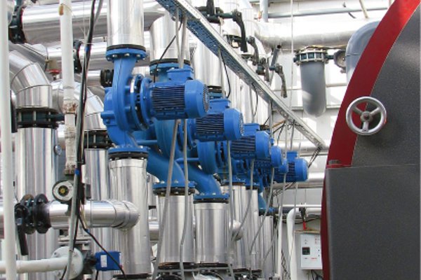

During a preliminary inspection of the boilers and auxiliary systems (prior to conducting the emissions testing regimen), I noticed that both of the 100 hp boiler feed water pumps were running. That was not normal. These two boilers were installed as a 100% redundant system. Mill steam load averaged 70,000 to 90,000 PPH summer to winter. One boiler generally was in service, and the second unit was in warm stand-by using a continuous blowdown heat recovery concept to keep it hot at line pressure.
Since I had visited the facility frequently in the past, I knew that the feedwater pumps (BFPs) were also 100% redundant. At a steam load of 90,000 PPH there should have been no reason for two pumps to be operating. Both pumps seemed to be running OK. I went to the control room to further check out the DCS data and have a discussion with the shift utilities crew.
After a brief update about recent activities, one operator informed me that both BFPs had been in service for the past several months. I then recalled my visit about a year prior when the maintenance foreman had approached me about performance issues with these pumps. We had inspected the pumps and I suggested that, due to their age, he consider a minor overhaul.
The pumps were two-stage, horizontal, split-case, double-suction design. I indicated to him that it was an easy, straightforward repair procedure: Remove the casing upper half; check the impeller eye, the wear rings, and the casing cut-water for erosion; and then repack the glands if everything looked normal.
So I asked the boiler operator if maintenance had overhauled the pumps. “Yes, last summer,” he said, “during the annual outage.” They found nothing abnormal other than worn packing.
The plant steam pressure was 215 to 225 psig and feedwater pressure was normally 340 to 360 psig with one pump in service. Each pump was rated for 290 gpm at 720 feet. The deaerator operated at 7 psig (233 F); however, it was installed on the roof of the boiler building with a pump elevation head of 30 ft. There was no way cavitation should be an issue with these pumps (40-plus ft of suction head).
I then asked the operator why they needed to run both pumps. “One pump could not maintain boiler drum level and header pressure during sudden steam load changes,” he replied. Two pumps in parallel could double the feedwater flow or increase the pressure to near a maximum shut-off head of 360 psig at 50% flow rate, I thought.

The feedwater flow certainly appeared high. Bottom blowdown valves were closed and cold, as were the bottom header drain valves. We seemed to have a combined FW flow of about 440 gpm for a steam load of 90,000 PPH. Each pump (at 220 gpm) was about 53% efficient and using a combined 148 hp.
From previous experience at other similar steam plant installations, I decided to check out the minimum flow recirculation lines. Each pump has a 1-in. line (before the discharge check valve) that returns to the storage section of the deaerator. These lines provide a minimum continuous flow of 10% (about 30 gpm in this case) to assure against a “no flow” condition inside the pump when the steam drum level control valve goes automatically closed.
Since the feedwater is 233 F, these lines are fully insulated and difficult to discern by an unseasoned operator. It took me a few minutes to locate the “orifice-plate” assembly about 3 ft above the pump casing. The aluminum jacketed lines were about 3-in. diameter and some of the insulation appeared to be new. I retrieved a screwdriver from my combustion analyzer toolkit to conduct a quick flow-velocity sound test.
With the pointed end against the recirculation line pipe and the handle end against my ear, it was quite apparent that the flow velocity noise was much higher than reasonable. Upon returning to the control room for further discussion with the operator, I learned both lines had developed leaks (at 90-deg elbow fittings) over the past year. He understood that they were minimum flow lines to protect the pumps from seizure, but knew nothing about location of the restrictive orifice that sets the proper flow rate.
It was time for me to speak with a staff engineer. It took a while to find the pumps’ file and dig out the piping schematics. The 1-in. lines indicated a stainless orifice plate between flanges with an orifice diameter of 0.135 in. Remember that feedwater pressure is about 340 psig. A severely eroded orifice plate (as I then expected) could easily flow well over 120 gpm back to the DA tank.
After some further discussion and a few calculations, I got his agreement that two pumps were operating very inefficiently. So, I proposed a quick field trial:
  1. We asked the boiler operator to temporarily close the 1-in. isolation valves in the recirculation line on both pumps (valves located before the orifice flange assembly at each pump). Immediately the load on both motors changed from 82 to 46 amps.
  2. After a few minutes of steady-state flow, we shut down pump No. 2. The amps on pump motor No. 1 increased from 46 to 73, about normal for a one-pump operation at 70% boiler load.
  3. Next, we switched to pump No. 2 and experienced similar results.
  4. Finally, opening the minimum flow line on pump No. 2 increased motor load to 86 amps.
  5. There was no question that the orifice plates were eroded away. After all, these boilers were 30 years old. The boiler operator then reminded us that a sudden steam load change (from a broke pulper heating cycle) could cause the boiler to trip. So, back to two pumps!

Mill engineering and maintenance later replaced the orifice plates in the recirculation lines with robust orifice pipe nozzles. The boiler plant returned to single feedwater pump operation with no subsequent troubles. Earlier, a single pump was fully loaded due to the eroded orifice plate. They went from two pumps consuming 148 hp to one consuming 65 hp, saving approximately $100 per day in electrical power.
