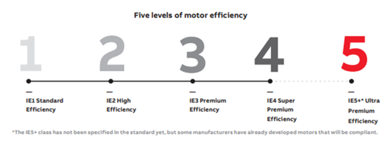

The induction motor, a century-old workhorse in industrial; heating, ventilation, air conditioning (HVAC) and refrigeration; and water applications has likely reached its efficiency limits. The most efficient induction motors have a NEMA Super Premium or IE4 rating. This means new innovative motor technologies need to be evaluated and adopted by the industry and installed in the field.
In the past decade, motor technology has advanced beyond the efficiency of induction motors, with many of these new designs requiring a VFD to operate, even if speed control or soft starting isn’t required. This means the traditional contactor-based bypass is no longer a viable option. The bypass served as a temporary emergency backup during VFD failures, allowing the induction motor to run directly across the line. Because new motor designs cannot operate this way, alternative solutions are used to increase uptime.
Figure 1: This highlights the five levels of motor efficiency. Courtesy: ABB
