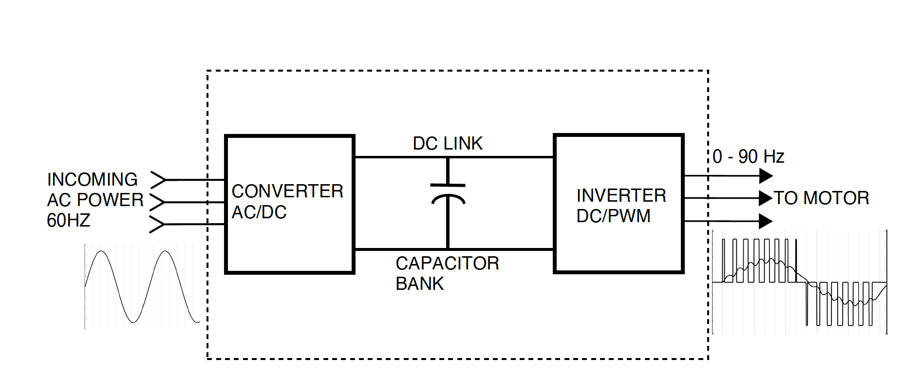

The main components of a VFD (see Figure 1) are:
  • The ac-dc converter, which converts the incoming 60 Hz ac signal to direct current (dc) using rectifiers or insulated-gate bipolar transistors (IGBT).
  • A dc link that smooths the dc signal using capacitors.
  • A dc-ac converter that takes the dc and converts it back to ac at the desired voltage and frequency using pulse width modulation (PWM) technique with IGBT transistors.
Figure 1: Variable frequency drive block diagram. Courtesy: CDM Smith

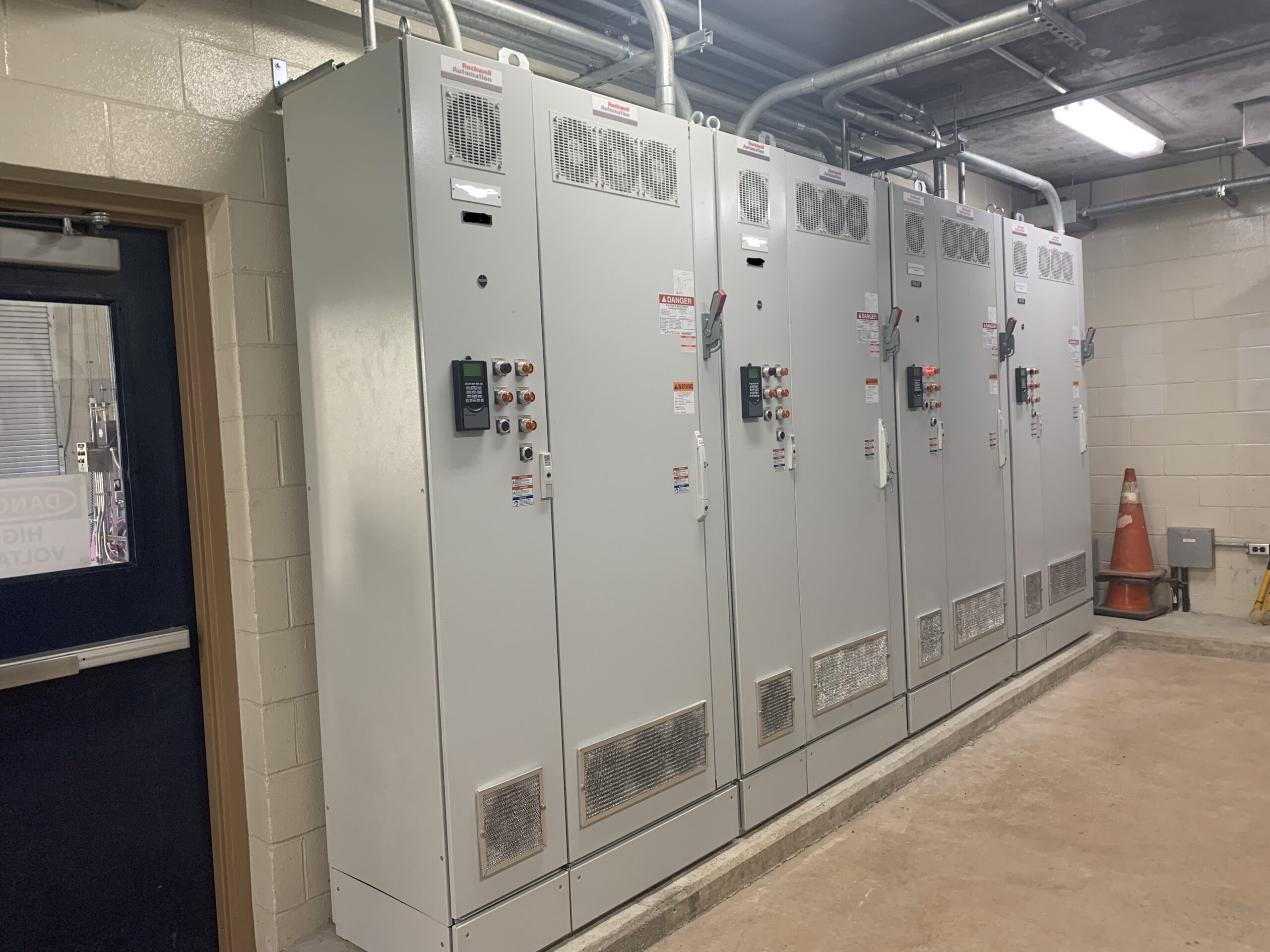

Like with anything else in industrial facilities, such as structural supports and pipes or other electrical equipment, motors and drives must be suitably rated for the environments in which they are installed. Process areas in industrial facilities can be subject to physical damage, sprayed or standing water, high humidity, dust, corrosive chemicals and extreme temperatures, all of which can damage or rapidly degrade VFDs containing sensitive electronics.
The VFDs can be protected from their environment with a properly rated National Electrical Manufacturers Association (NEMA) enclosure, such as 4X stainless steel. However, these enclosures come with their own drawbacks. They have larger footprints, add additional cost and make it harder to remove excess heat generated by the VFD. For these reasons, it is recommended to install VFDs in dedicated, climate-controlled electrical rooms (see Figure 2).
Figure 2: Variable frequency drives installed in environmentally controlled room. Courtesy: CDM Smith

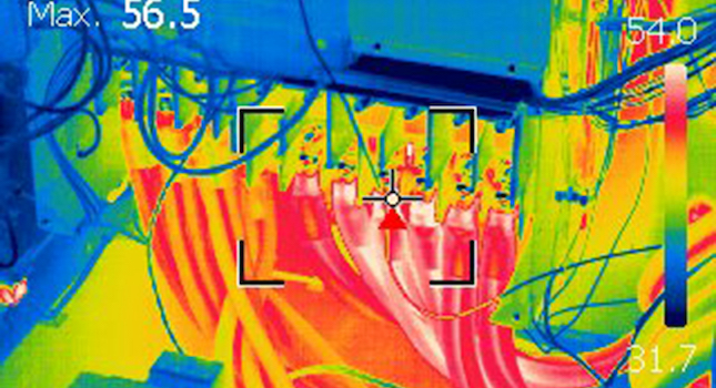

Equipment heat degradation
When it comes to electrical and mechanical equipment, one of the biggest reasons for degradation of equipment is heat. The power electronics that make up VFDs generate heat and if this heat builds up within the VFD enclosure, the components can be damaged, operate inefficiently or cause the VFD to shut itself down for protection, forcing equipment downtime. Most VFD enclosures are equipped with fans and air filters to ensure the flow of clean air across the components.
As with home air filters or on-facility heating, ventilation and air conditioning equipment, the air filters will become clogged with particulates and dust, inhibiting airflow. Even when the VFDs are installed in an air conditioned space and the heat cannot escape the VFD enclosure, the damage will be done.
It may seem like a small thing, but changing the air filters on VFD enclosures regularly, as well as verifying the functionality of the fans and ensuring a clear space around the vents can extend the longevity of the VFDs.
When a VFD is installed in a harsh environment, it is important to remember that the NEMA-rated enclosure only provides protection when used and maintained appropriately. For example, a NEMA 3R outdoor enclosure protects the VFD from rain, but if the door is left ajar, it may as well have a NEMA 1 enclosure rating. Enclosures that provide stronger protection (3R, 4X, 7), tend to have more and heavier duty latches and bolts to keep the doors closed.
These are the areas where the environment can do the most damage to the VFD, so it is crucial for the longevity of the drive to make sure the doors stay closed, ensuring the integrity of the enclosure is maintained.

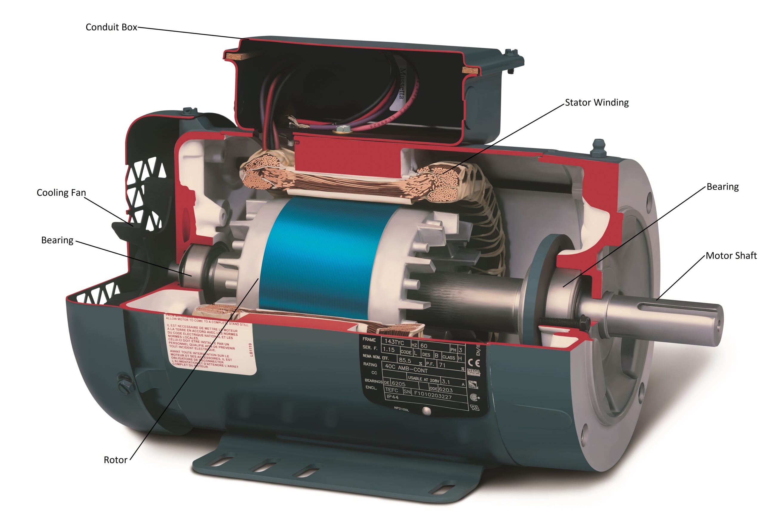

Similar to VFDs, heat buildup is an issue for the motors. The flow of electrical current is resisted by the motor windings, converting the electrical energy to thermal energy. In a motor, a fan blade is attached to the rear of the shaft to expel hot air while the motor is spinning. This kind of motor construction is called totally enclosed, fan-cooled (TEFC) (see Figure 3) and it works well to remove excess heat from the bearings and stator at rated speed.
Figure 3: Totally enclosed, fan-cooled motor on variable frequency drive with winding thermal protection and safety disconnect. Courtesy: CDM Smith
However, when used with a VFD to reduce the speed of the motor, as the fan is attached to the shaft, it will spin slower, which reduces the effectiveness and allows heat to build up. Generally, it is not recommended to operate TEFC motors below 25% of rated speed without additional cooling or verifying the rating of the motor.
For motors driven by VFDs especially, monitoring the temperature can help identify problems before they do too much damage. The most basic method is to install thermostats constructed from bi-metallic switches around the stator windings. As the two distinct types of metals heat up, they expand at different rates, eventually breaking contact, letting the control circuit know the motor is getting too hot.
However, this discrete signal occurs only after reaching the setpoint and provides no additional diagnostics. Another method is using resistance temperature detectors that continuously vary their resistance as the temperature changes, which can be sensed and monitored remotely, giving more opportunity for proactive intervention to extend the life of the motor (see Figure 4).
Figure 4: Cutaway view of an induction motor. Courtesy: ABB
