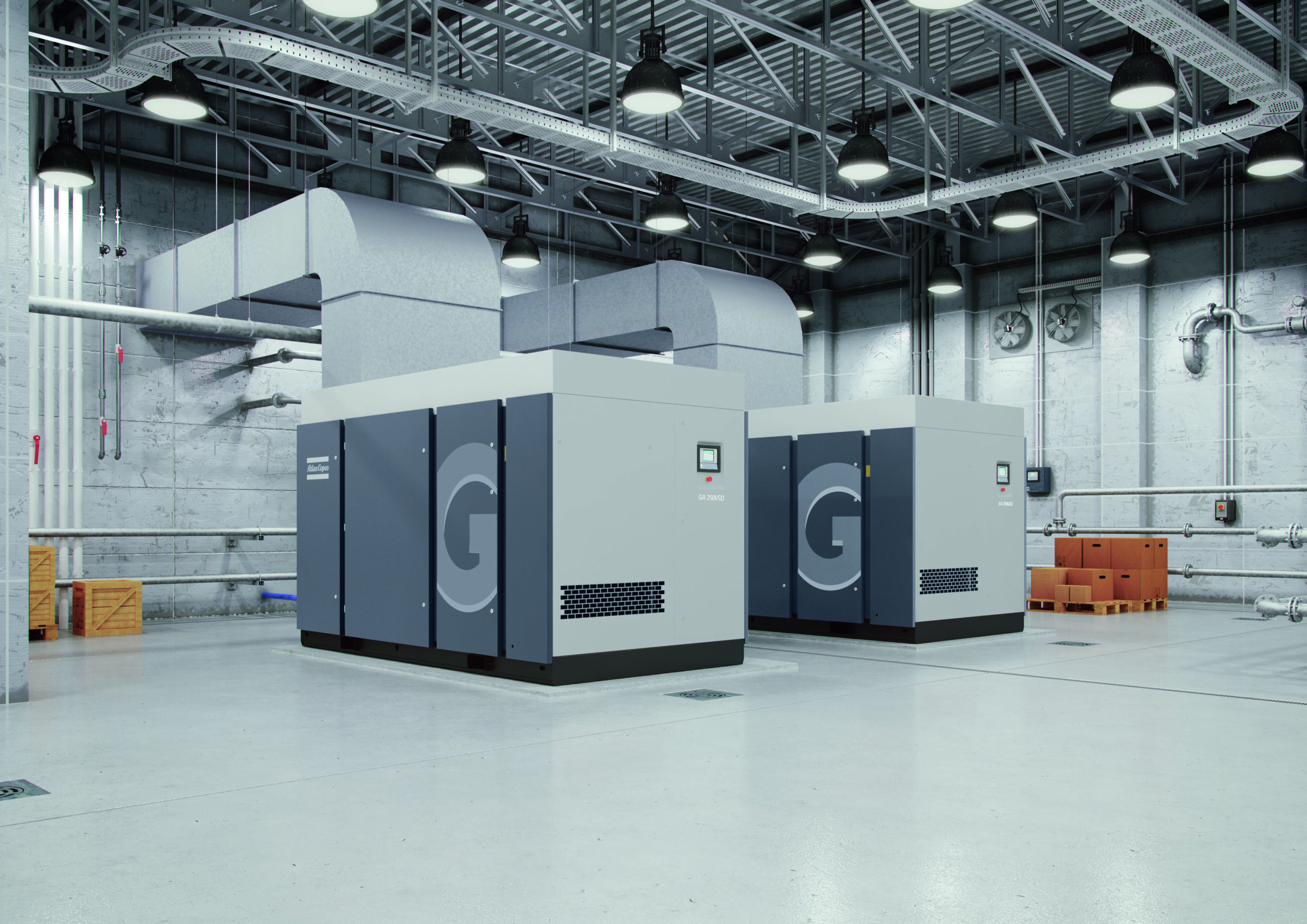

Atlas Copco's GA VSD product line brings energy efficiency and reliability for industries worldwide. Courtesy: Atlas Copco
Atlas Copco’s GA VSD product line brings energy efficiency and reliability for industries worldwide. Courtesy: Atlas Copco
