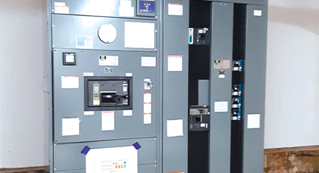

Switchgear
In IEEE standards, switchgear is expressed as a general term that describes switching and interrupting devices, either alone or in combination with other associated control, metering, protective and regulating equipment, that are assembled in one or more sections. The switchgear functions to regulate, protect and isolate a power system with a variety of controls housed in a metal enclosure. This facilitates switchgear to be used for both primary service and distribution equipment.
The requirements for distribution equipment are described in NEC Article 408: Switchboards, Switchgear and Panelboards. The electrical equipment referenced in Article 408 basically accepts power from a source and distributes it to other protective devices or equipment. Unlike switchgear and switchboards that are applicable in larger facilities, panelboards operate on smaller scales and serve as final distribution points, feeding the branch circuits that contain electrical devices.
LV switchboards offer a compact footprint and cost-effective solutions for service entrance applications rated at or below 1,000 volts. Switchgear operates in a wide range of voltage ratings, from below 1,000 volts up to 500 kilovolts in the U.S. It is generally the most robust in construction and expensive compared to other electrical distribution equipment.
LV, MV and HV switchgear are the major types of switchgear; this article will focus on LV switchgear. LV switchgear has the following ratings:
  • Maximum voltage: 1,000 volts.
  • Bus current rating: 1,600 to 6,000 amperes.
  • Short-circuit withstand current: up to 200 kiloamperes.
  • Short-time withstand current: typically up to 100 kiloamperes, 30 cycles.
  • Breaker configuration: draw-out.
  • Insulation level: typically 2.2 kilovolts.
  • Power frequency: 50 or 60 hertz.

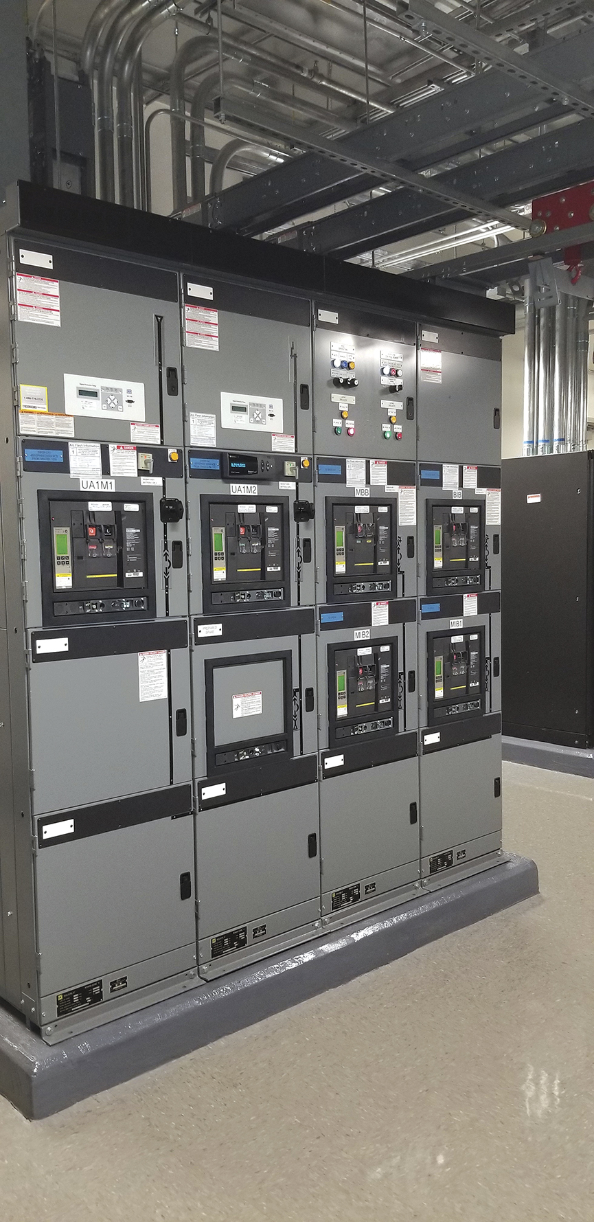

Switchgear safety
LV switchgear is designed for high power handling capacity and its protection devices are used to de-energize equipment to safely carry out testing or maintenance work and to clear faults downstream. It provides the benefits for safety and reliability for a stable and constant power supply. Features like manual control provision, fault operation, absolutely certain discrimination and complete reliability are essential to switchgear operations.
When it comes to low voltages — 1,000 volts or below — the terms “switchgear” and “switchboard” are often used interchangeably. LV switchgear is tested UL 1558 and ANSI C37.20.1. LV switchboards are constructed to UL 891. UL 1558 incorporates a number of requirements that enhance the reliability, durability and maintainability above the requirements of UL 891. Both can operate together in tandem, to provide maximum protection and coordination (see Figures 3 and 4).
A typical section of LV switchgear consists of breakers, bus and cable compartments. Each vertical section can hold up to four power circuit breaker compartments and each power circuit breaker is individually isolated from other breakers. The extensive compartmentalization of LV switchgear is designed to increase the safety, reliability and serviceability of the switchgear by preventing accidental contact with certain conductors such as the main bus or circuit breakers in adjacent cells, which can happen while performing maintenance or during installation. In the event of a short circuit inside a compartment, the resulting energy will be contained within the compartment and isolated from other breakers, bus and cable compartments.
A collection of one or more of these sections or structures is called a switchgear line-up or assembly. A switchgear line-up consists of a complete assembly of one or more of the overcurrent protection devices. Switchgear uses draw-out breakers with front and rear access, with each breaker in its own separate compartment described above. All the draw-out breakers can be detached from the bus and removed for inspection, maintenance or replacement without shutting down the main or disrupting the other breakers in the switchgear assembly.
LV switchgear breakers are typically LV power circuit breakers with integral trip units, designed to meet UL 1066. LV power circuit breakers are rated to withstand a short circuit condition for up to 30 cycles (0.5 seconds). This is in contrast to LV switchboard breakers, which are designed to withstand a short circuit condition for up to three cycles (0.05 seconds). Ordinarily, switchboard construction comprises molded-case individual or group mounted breakers.

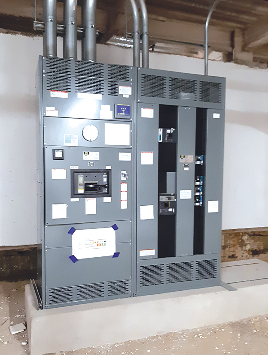

Figure 4: Typical switchboard (under construction). Courtesy: Page
Switchgear versus switchboards
In a main-tie-main configuration, switchboards can use draw-out main and tie-breakers to save the cost of procuring switchgear. The breaker trip settings for a switchboard could be thermal-magnetic or electronic while electronic is only applicable in switchgear.
Although the cost of switchgear is higher compared to a switchboard, both units have different capabilities and functions. The decision to use a switchboard, switchgear or both will depend on the facility’s power requirements. These requirements will dictate space consideration in the equipment selection and should be established early in the design stage. Working space around all types of electrical equipment must meet the requirements of NEC Article 110.
Both switchgear and switchboards require periodic maintenance including cleaning, lug torquing and lubrication of the moving parts of draw-out breakers. Proper switchgear maintenance and testing regimes, performed by qualified personnel, will ensure a constant power supply is not disrupted.

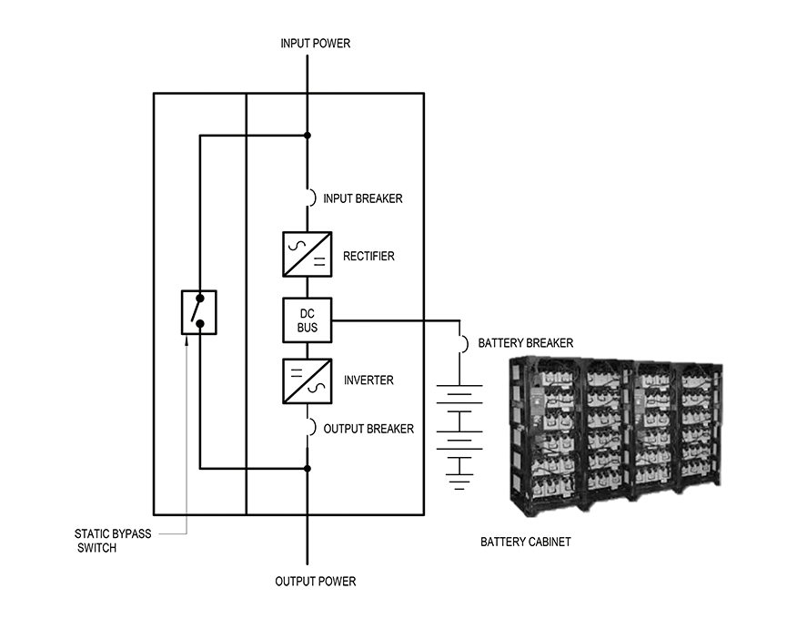

UPS topology
Standby is the most basic UPS topology. It allows the load to run off utility power until the UPS detects power loss and switches to battery power. This type of topology is designed for security systems and other basic electronic equipment.
A line-interactive UPS incorporates technology that regulates voltage to correct minor power fluctuations without switching to a battery. Line-interactive UPS models are typically ideal for applications where protection from abnormal power is required.
A double conversion (online UPS) provides consistent, clean power regardless of the condition of incoming power by isolating equipment from raw utility power, converting power from AC to DC and back to AC (see Figure 5). Unlike other topologies, double-conversion provides zero transfer time to the battery for sensitive equipment. Double-conversion UPSs are designed to protect mission critical information technology equipment, data center installation and advanced network equipment from damage caused by utility-supplied problems.
Figure 5: Typical one-line uninterruptible power supply diagram. Courtesy: Page
Thus, the following information is required for specifying or designing a UPS system:
  • Load (in kilovolt amperes).
  • Input voltage and output voltage.
  • Voltage range: +10 to -15% of nominal with no battery contribution.
  • Number of phases.
  • Starting current, associated with motor and transformer.
  • Power factor.
  • Battery backup time.
To establish appropriate power consumption, identifying the loads that the UPS is required to serve should be examined first. While UPSs are typically designed to back up IT systems they can sustain other loads, like dimmable lighting systems, laser printers, motors or compressors, but there are limitations due to high starting currents that will drain the batteries faster if these short-term starting loads are not accounted for in the battery calculations. It is typically recommended to keep these loads off UPS and alternate means are found to keep these loads running, e.g., a backup generator.
Knowing the UPS run-time will help determine its battery cabinet footprint, which allows the appropriate space planning for the installation.
Capital costs of the UPS system are driven by battery type and by the reliability required of the load, i.e., N, N+1, N+2, etc., where additional equipment is provided to enable the UPS to reach the reliability required.
